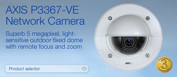

thewireguys 3 Posted April 13, 2012 I don't mount dome cameras on the wall like this for this reason. Have a look at what axis does. Share this post Link to post Share on other sites
ljarrald 0 Posted April 13, 2012 i like what axis cameras do. although there would still be a bit of the problem if the lens was pointed right down and the rain was at a sharp angle. unfortunately, i don't have much money. so i have to make do with what i've got. i would LOVE an axis system. lol Share this post Link to post Share on other sites
