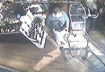

Should I be concerned with the whole digital/megapixel vs analog cameras? Is there that big of a difference? I want to be able to stream the videos live off of my wireless internet signal when I'm away from my business if that helps.

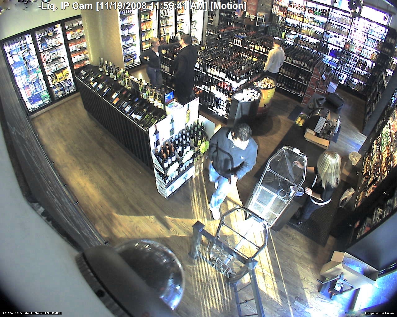

Here's an analog camera recording at CIF resolution (352x280) in a liquor store:
Here's an IQEye IQ511 1.3MP camera mounted right above it (click for full-size image, as the forum shrinks it for display -note the cheap dome in the bottom-left of the frame):

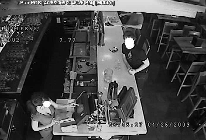

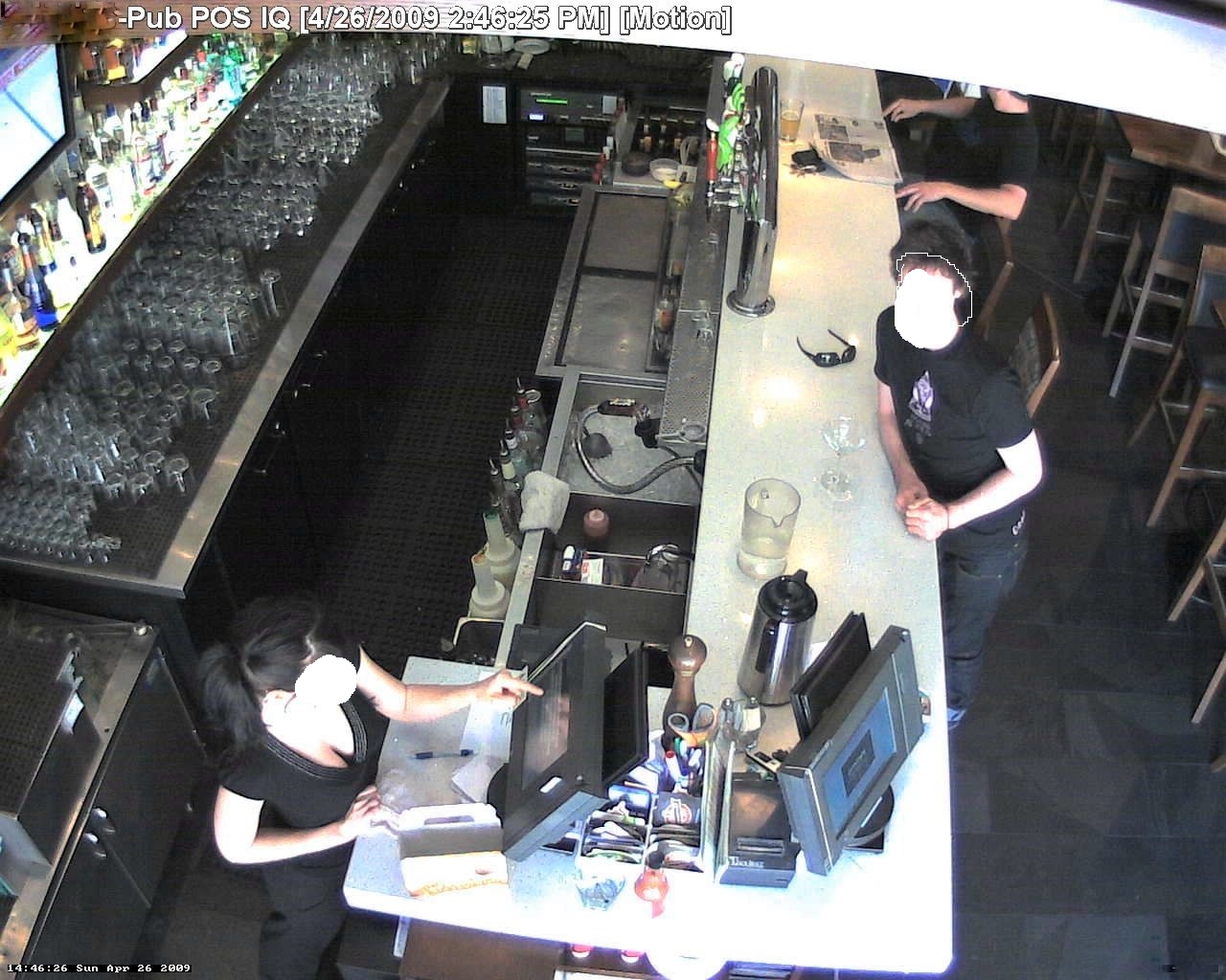

Over in their attached lounge, this is the same model cheap dome recording at D1 (720x480):
And this is the same model 1.3MP camera mounted right beside it::

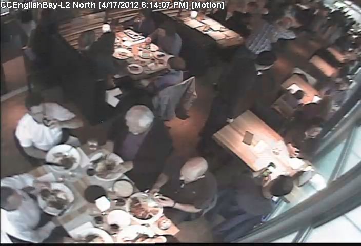

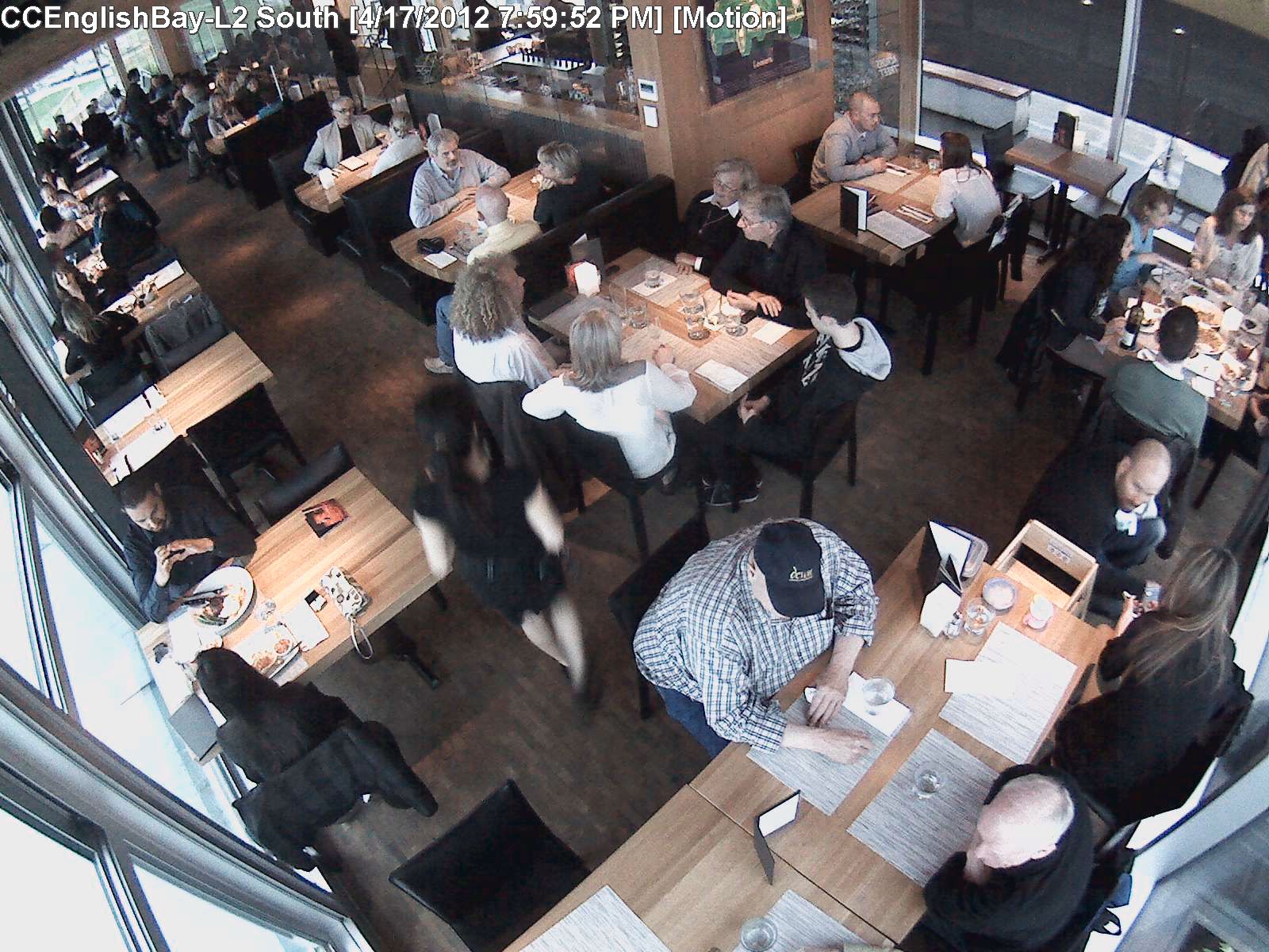

In our latest restaurant job, this is an analog camera recording at D1 at one end of the upstairs lounge:
And this is a 2MP dome at the other end of the lounge (again, click for full size):
