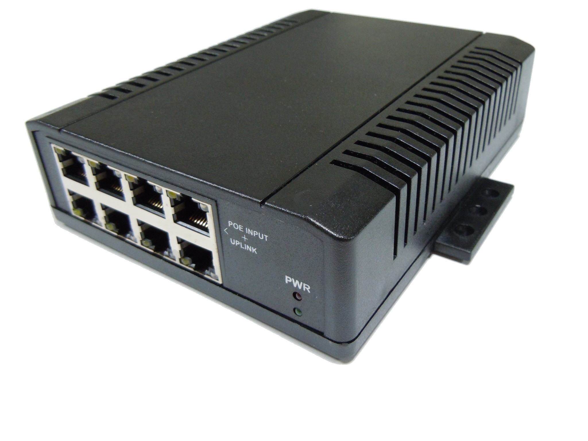

EOppie 0 Posted May 7, 2012 Have a small residential system, this little switch looks like it may fit the bill. Tycon Power 8 Port High Power POE 10/100 Switch Anyone used it or something similar? http://tyconpower.com/products/POE.htm http://tyconpower.com/products/files/TP-SW8_POE_Switch_Spec_Sheet.pdf Share this post Link to post Share on other sites
voip-ninja 0 Posted May 7, 2012 I have used a somewhat similar one from Netgear that is a 16 port 10/100 switch with 8 ports of PoE for the IP phones at my wife's office. What's nice about it is that since you have some non PoE ports to use, you can use one of those to trunk up to the rest of the network and really have all 8 ports available for PoE devices. With the one you have linked you will only really be able to drive 7 devices if you plan on connecting this to the rest of the network. The downside is that all of these small PoE switches use an external 48V AC transformer, and they, or the power input on the switch are somewhat prone to failure. I've already gone through one of the Netgear units at my wife's office, after 3 years it gave up the ghost and died. If I wanted something like that, I would get this one from Cisco, it's cheaper and probably better supported; http://www.bhphotovideo.com/bnh/controller/home?is=REG&sku=813246&Q=&O=&A=details Share this post Link to post Share on other sites

NotoriousBRK 0 Posted May 8, 2012 The main thing to look out for on the cheaper PoE switches is their *total* rated power. They may supply power on 4 or 8 ports, but sometimes it might have a low limit (30 Watts, etc.), which prevents it from supplying *full* power on all ports. Make sure whatever you intend to use with it won't exceed its power budget. Share this post Link to post Share on other sites
MaxIcon 0 Posted May 8, 2012 Interesting device! Looks to me like it's got 2 potential benefits over mainstream POE switches. - High power output - 35W/port! That could be useful for driving high power devices (heater/fan enclosures, for instance), assuming the receiving end can deal with it. The POE standard is only 15.4W per device, so the extra power may not be useful for most gear. - POE input port - that could be useful if you wanted to run it as a simple remote switch; I'm assuming you wouldn't be able to run much POE gear off of it that way due to the input power limitations. Again, a bit of a limited and specialized app. As voip-ninja said, you'll only have 7 ports available for running gear. I've already maxed out my 8 port switch due to this, and am shopping for an inexpensive 24 port. Mine is 60W POE budget for 8 ports (7.5W max per port average if all are used), but I've had no problem running 7 assorted cams from it. I only have a few cams that run over 5-6W, so there's extra budget for the higher power ones. Also, none of the ports are GB and there's no spec on the fabric bandwidth, so it's possible you could have data rate problems, depending on what you're transferring over it. I like to have at least one GB port for connecting to the rest of the network. I'm also fond of managed switches, so you can monitor power usage, but I'm a data geek. For the money, I'd go for something more mainstream. Share this post Link to post Share on other sites

HiroPro 0 Posted May 14, 2012 (edited) Quote What does 802.11f Inter-Access Point Protocol have to do with POE complaint switches? http://en.wikipedia.org/wiki/Inter-Access_Point_Protocol Just an obvious typo/brainfart. That's a very powerful type 2 he's linked to. Dunno what you'd need that kinda power for though! Just be sure it's proper compliant in that it does negotiate PoE injection etc. Cheap non compliant "af" over "at" models can stupidly always sends juice down the segment. Plug those suckers by accident into a GigE PHY and it will surely blow up or take out SMT fuses and require SMT PCB rework. Some PSE use layer 2 to negotiate power "injection" as well. IMHO non intelligent/negotiated 802.3af PoE injection is DANGEROUS. Thanks for sharing that info EOppie as Tycon Power has some really nice looking gear and the pricing looks decent! Edited May 14, 2012 by Guest Share this post Link to post Share on other sites

HiroPro 0 Posted May 14, 2012 thewireguys said: fa chris said: http://www.transition.com/TransitionNetworks/Products2/Family.aspx?Name=SISTP1010-380-LRT&ProductID=45374 Lots of industrial switches out there for this, but they are pricey. Been looking for another option for a 12VDC POE switch thank you!! That is a very nice looking "industrial" unit and even look at it's temp ratings etc. I recognize that name from YEARS AGO setting up thin-net back in the late 80s early 90s I think. I bet a lot of solutions for boats, cars and RVs use those. They have a non 12V model for 120V that has the same specs but adds two SFP ports. It's called SISPM1040-182D-LRT. Great product from the looks of it thanks for sharing. thewireguys that Tycon Power unit also has 12-57V DC input on a block on the NC model! VERY VERY NICE. owhh and input power can also be on a block and there is two for power fallback. WOW thanks for sharing the info on that TP-SW8-NC OP! On paper that a very versatile unit that can handle compliant and non compliant at various voltages as well as having DC and AC powering solutions with 2 blocks for power fallback etc. And it starts at $170 bucks! SMOKING DEAL from the looks of it. I'm amazed at how many cameras are not proper 802.3at compliant like the 12V ACTi units. Maybe I'm wrong here and they use layer 2 LLDP to negotiate voltage to 12V ? They claim class 3 compliance. I don't get why they would use 12V like that. You'd think from a engineering standpoint if your device uses the current to be class 3 then you'd be much smarter to use a higher voltage for PoE. As a note the Axis M11s that I'm comparing to the ACTi TCM-1231 are class 1 and use 48V standards 802.3at type 1. 48V will have a lot less insertion loss than 12V ! Share this post Link to post Share on other sites
