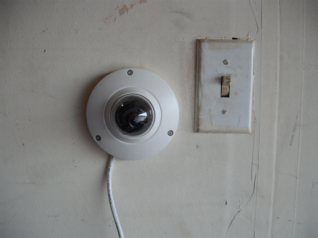

nDAlk90 0 Posted May 25, 2012 Seems like not a bad camera. Can you show us how the camera looks mounted on a wall or ceiling tile? SEANHAWG said: You use the PSS client software to connect to the IP camera. The IP camera acts as the sever: Share this post Link to post Share on other sites

Integraoligist 0 Posted May 25, 2012 xellbuy said: Seems like not a bad camera. Can you show us how the camera looks mounted on a wall or ceiling tile? That would be great! Share this post Link to post Share on other sites

SEANHAWG 1 Posted May 25, 2012 <---- Basically, just like it looks on the ad on the left side of the page Unfortunately, I dont have any installed here at my location, I just have them "propped up" with the dome glass cover off because I am constantly playing with it. I will try to get some installed pics from some customers. Its a real small dome so it fits well in most indoor or outdoor applications. Alot of people are amazed at how small it is. you can take a look at the unboxing video on the cameras tech page to see how small it is compared to my hand. I have PM'ed the link to the 2 requesting individuals. Share this post Link to post Share on other sites

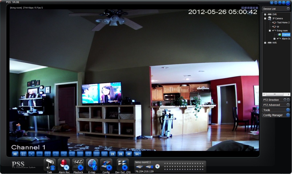

SEANHAWG 1 Posted May 25, 2012 Quote So is that the software you posted the screen shot of? Yep Share this post Link to post Share on other sites
nDAlk90 0 Posted May 25, 2012 They say "A picture is worth a thousand words". A picture would be very helpful in seeing how it looks installed. SEANHAWG said: <---- Basically, just like it looks on the ad on the left side of the page Unfortunately, I dont have any installed here at my location, I just have them "propped up" with the dome glass cover off because I am constantly playing with it. I will try to get some installed pics from some customers. Its a real small dome so it fits well in most indoor or outdoor applications. Alot of people are amazed at how small it is. you can take a look at the unboxing video on the cameras tech page to see how small it is compared to my hand. I have PM'ed the link to the 2 requesting individuals. Share this post Link to post Share on other sites
SEANHAWG 1 Posted May 25, 2012 Quote A picture would be very helpful in seeing how it looks installed. Just for you Robert: Installed in 2 seconds flat, literally. This is about the best I can do for now, until I get a real installation picture. But put it next to the light switch for size comaprison. Share this post Link to post Share on other sites
nDAlk90 0 Posted May 25, 2012 Thanks Sean. Actually I really appreciate you taking the time to post the picture. We get a sense of scale of the camera and are able to see how it looks on a wall. Very good... Now if only it would work with Aver Nano... SEANHAWG said: Quote A picture would be very helpful in seeing how it looks installed. Just for you Robert: Installed in 2 seconds flat, literally. This is about the best I can do for now, until I get a real installation picture. But put it next to the light switch for size comaprison. Share this post Link to post Share on other sites

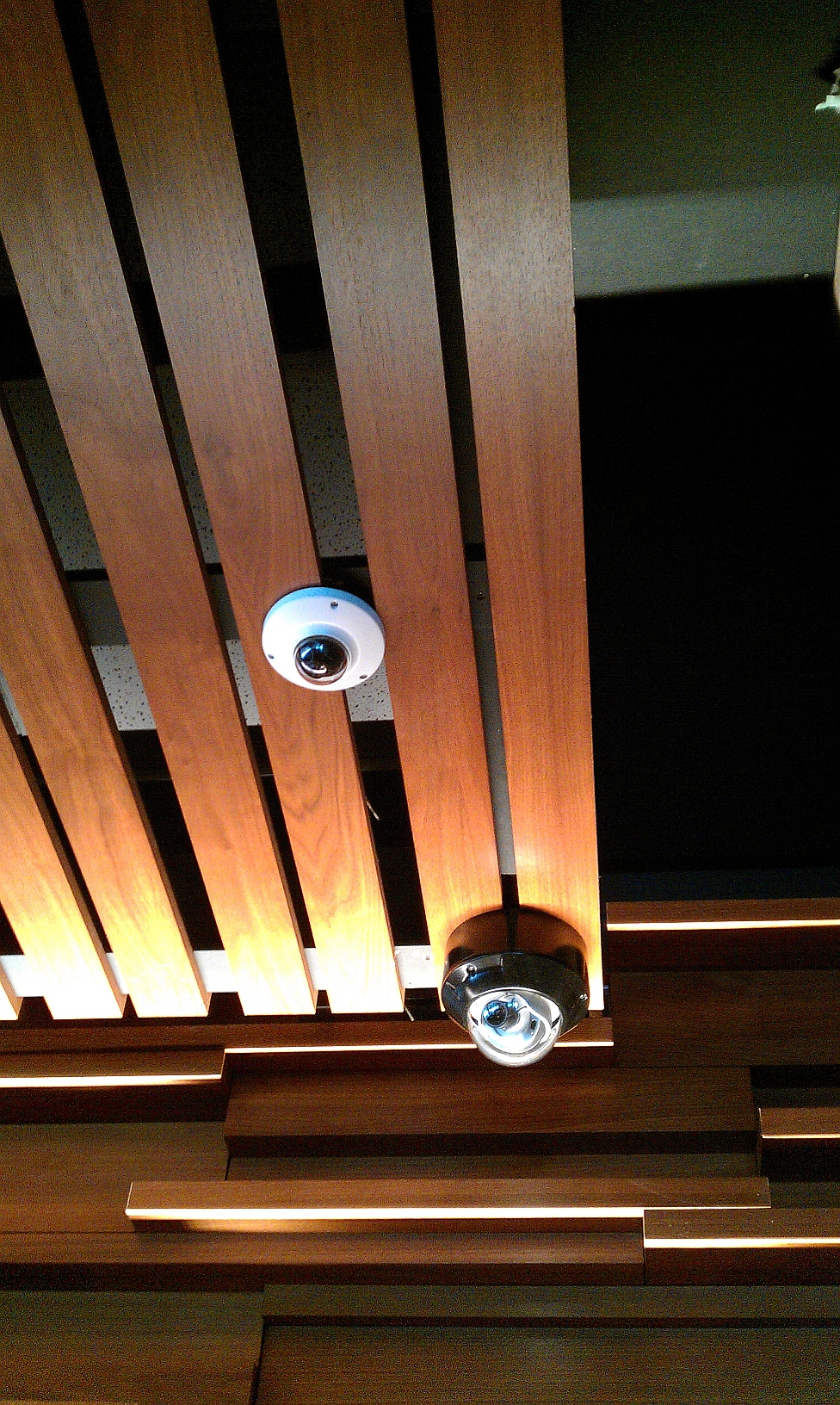

Soundy 1 Posted May 25, 2012 Integraoligist said: I know this is a noob question... but what is Aver? http://surveillance.aver.com/types/Embedded-hybrid-DVR xellbuy said: Can you show us how the camera looks mounted on a wall or ceiling tile? Temporary test installation, beside a 3xLOGIC VSX-2MP-VD dome: Share this post Link to post Share on other sites
nDAlk90 0 Posted May 25, 2012 Nice. Thanks Soundy. How does the picture quality compare? I actually like the look of the white Dahua camera better. Less obstructive, lower profile. Soundy said: Temporary test installation, beside a 3xLOGIC VSX-2MP-VD dome: Share this post Link to post Share on other sites
