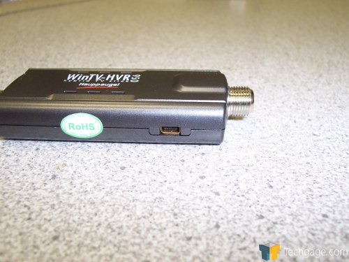

7kMI 0 Posted May 17, 2012 DSR3009 that is the old sanyo P. you are looking at 8 years old. you also need the viewing software to view on a PC. and also the people you give the footage to will also need the player. you can like you said go direct to video player. but if you are going to keep the system then i would go for something like the avermedia converter. it will give your dvr a few more years use. plug into monitor out into pc press record on pc screen display direct to dvd. http://www.avermedia.com/Product/ProductDetail.aspx?Id=505 Thanks for the reply. I've had a USB TV tuner for years (Hauppauge HVR-950), and always wondered if there was a way to import analog video. Turns out I just need to order a cable that connects to it. Later models included the cable. Should be able to get what I need between media center and movie maker. Thanks again, wouldn't have thought of it without the message. Share this post Link to post Share on other sites

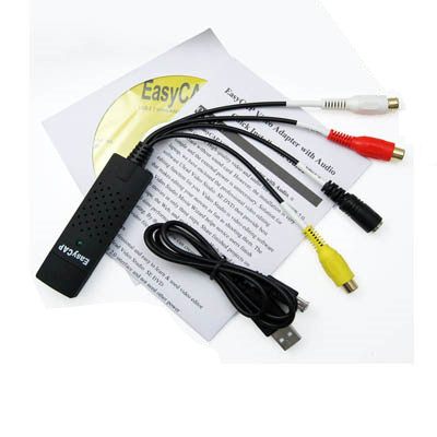

tomcctv 190 Posted May 17, 2012 Thanks for the reply. I've had a USB TV tuner for years (Hauppauge HVR-950), and always wondered if there was a way to import analog video. Turns out I just need to order a cable that connects to it. Later models included the cable. hi. no that will not work. you would also need to add a modulator ........ it would be cheaper to just buy a $10 USB dvr from the likes of amazon Share this post Link to post Share on other sites
7kMI 0 Posted May 17, 2012 Hauppauge has the cable & remote for sale as an add-on kit, looks like the cable plugs into the side of the tuner. Any reason you don't think it would work? Share this post Link to post Share on other sites
tomcctv 190 Posted May 17, 2012 hi. yes with that Hauppauge you can. but like i said from amazon the dvr pens are $7 upwards which is cheaper than buying the add on leads and remote (which you dont need) Share this post Link to post Share on other sites
