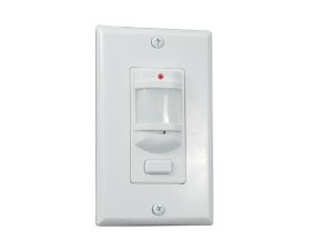

Soundy 1 Posted May 20, 2012 Same camera, with motion-activated light. Think of it this way: imagine you're someone breaking into the garage... you're probably going to be prowling around with a flashlight. If a light comes on, the first thing you're going to think is, "oh crap, I wonder if I've been spotted" and you'll look toward the source of the light to see if someone's there. If there's a camera beside or near that light... you're going to be looking right at it. Better yet, for inside: put some or all of you your regular garage lighting on a motion sensor, then put the camera right above the door. Dude comes in, triggers the lights, turns around to bolt out the door... and you've got him. Something like this also means you don't have to fumble around for the switch when YOU go in the garage at night: IR may allow you to watch him skulking about in the dark with his flashlight, and you might able to watch him taking things... it won't necessarily help you identify him if he keeps his head down. A bright light coming on will make him look around, thus improving your chances of catching his face... and ideally, it simply scares him off without actually taking anything. And if he does stay and take something, you have a much clearer, full-color picture of it. Share this post Link to post Share on other sites
groovyman 0 Posted May 20, 2012 Same camera, with motion-activated light. One of my clients has those installed in the bathrooms of all his retail locations. It was done to save on electric due to the bathrrom lights and fans being on for days, weeks or months at a time. They work great. Share this post Link to post Share on other sites
