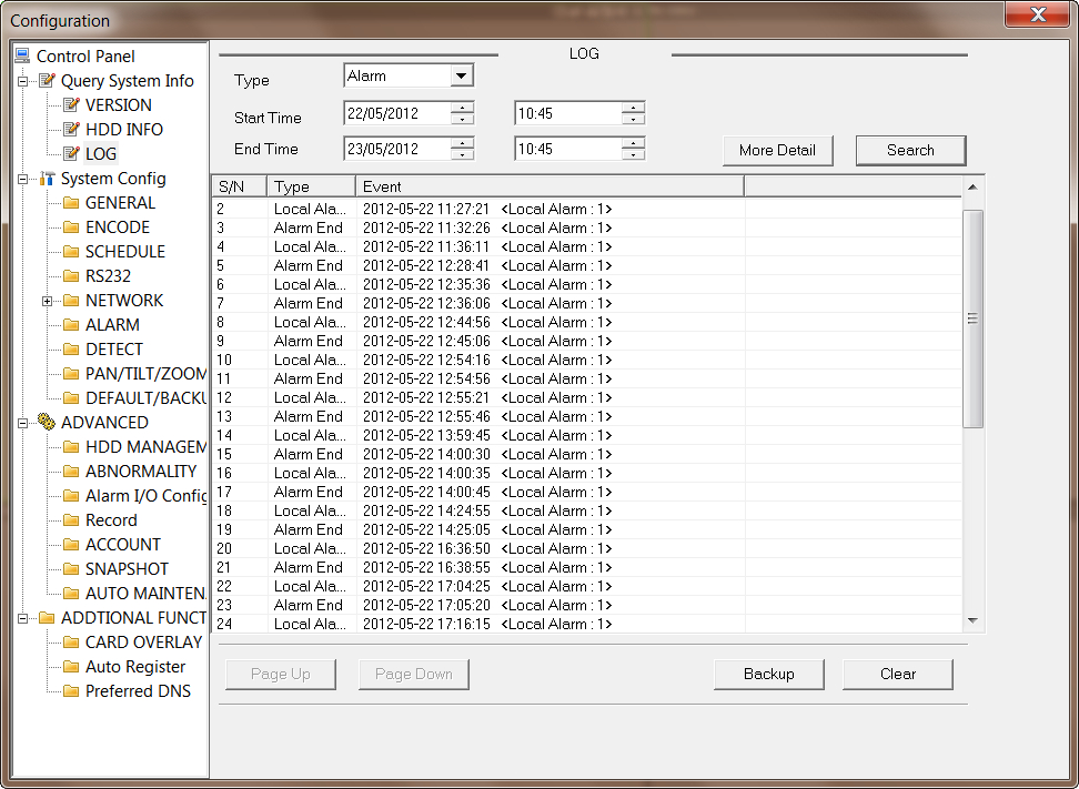

I have one alarm input sensor that is attached to a door. The DVR always logs the door movement correctly (see below). Local Alarm – door open. Alarm End – door closed. The problem is the email notification is inconsistent. The way it seems it should work with this DVR is you receive an email alert when the door is opened and another when the door is closed. Often you only receive one email, on open and closing of the door and a few times no email has been sent. The sending interval is set to 3 seconds. I have tried 3 different email smtp setting with the same results. Please see below for screen shots. Is there anything else I can try?

Updated the firmware with the latest on ADATA website. The update seemed to work as i heard the beep the DVR makes when rebooting, however when checking the firmware no. and build no. they are still the same? I also checked the logs and they don't show any 'sigh' the firmware has been updated, tho' they may not in any case.
The door alerts are still inconsistent.
Will try the update again, when next onsite.
