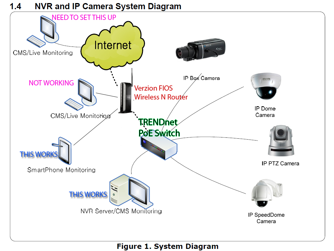

Need some help...I am in testing mode right now. The CNB NVR software is working great. I also was using the CNB CMS software on the same machine for testing. Both are working great. The CNB iPhone app is also working. When connected to my wireless network, I can view my cameras on my iPhone.
Now I want to use the CMS on my laptop when connect to my network, but it keeps saying my local NVR server is not found. I have not made any changes to my Fios router, everything has been PnP so far. I tried my laptop hard wired directly to the TRENDnet switch and to my FIOS Router. I exported the NVR server settings file from the CMS running on the local NVR machine and imported it in the CMS installed on my laptop. Still didn't work. It's probably a simple configuration setting, but I am not a network guru. Any help would be great.
Here is a diagram of my setup...the cameras are different models though. Thanks!
I finally got the CMS working on my laptop through my Wireless FIOS Router. I had the wrong IP. Now I just have to setup viewing from the internet and I am good to go.
