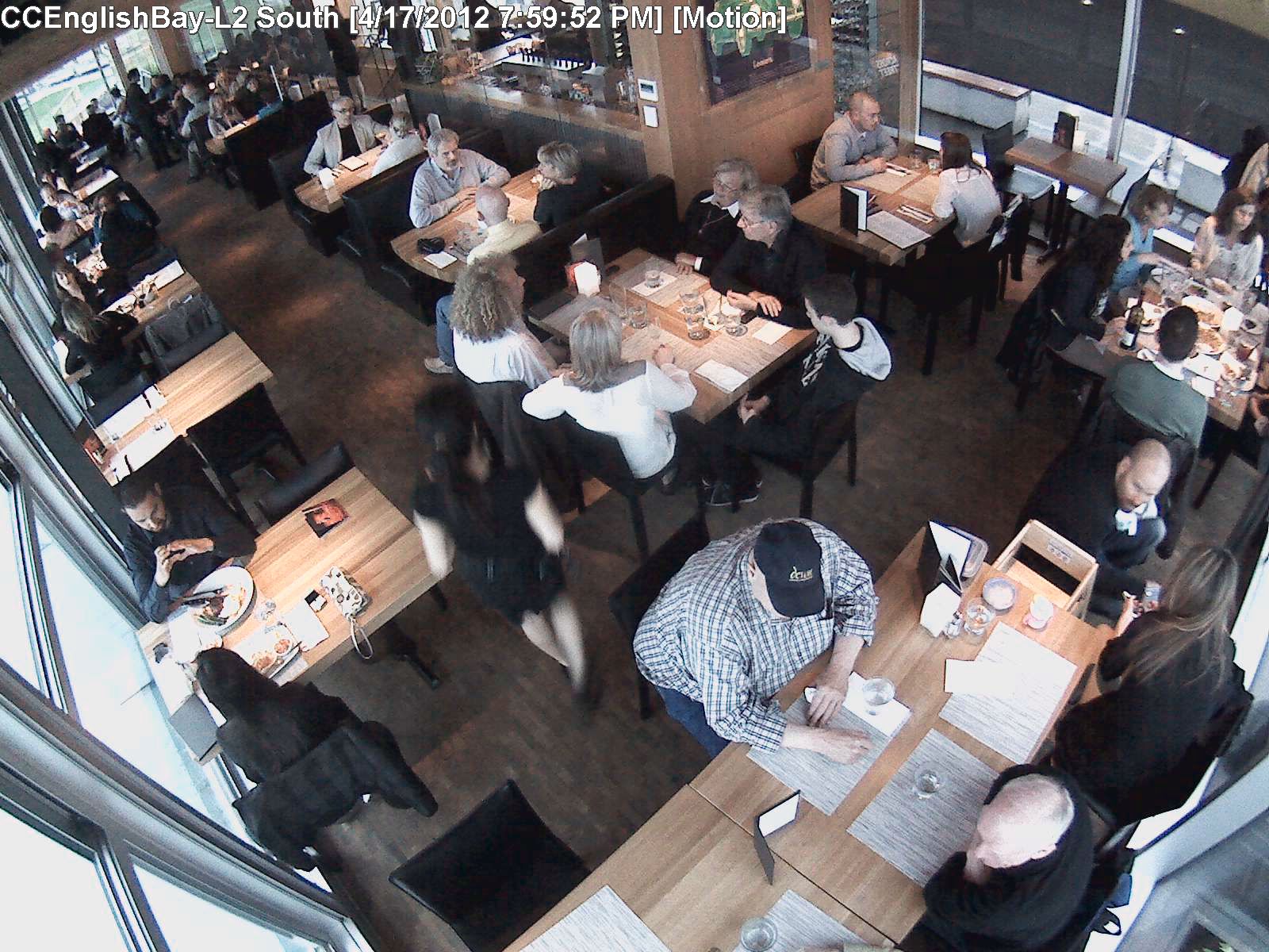

Can't go wrong with Cat5. I am incredibly thankful they ran it as our building was remodeled; its all buried in walls now. I remember thinking I would not get the budget for megapixel cams until years down the road. Then, a year later, after the wire install they told me to get them. Here are some pictures showing analog versus IP and some additional info on ip cams. Nothing wrong with analog cams - still have a bunch of CNB VBMs going strong.

In *complete* darkness, you need to provide some sort of illumination... however, if you have at least SOME lighting in the area, the CNB VCM-24VF is a good analog camera: works with very little ambient light, vandal-resistant dome, IP65 rated so it can be used in direct weather, dual-voltage, versatile 2.8-10.5mm lens. That's the upper camera in jxk716's comparison shots above.

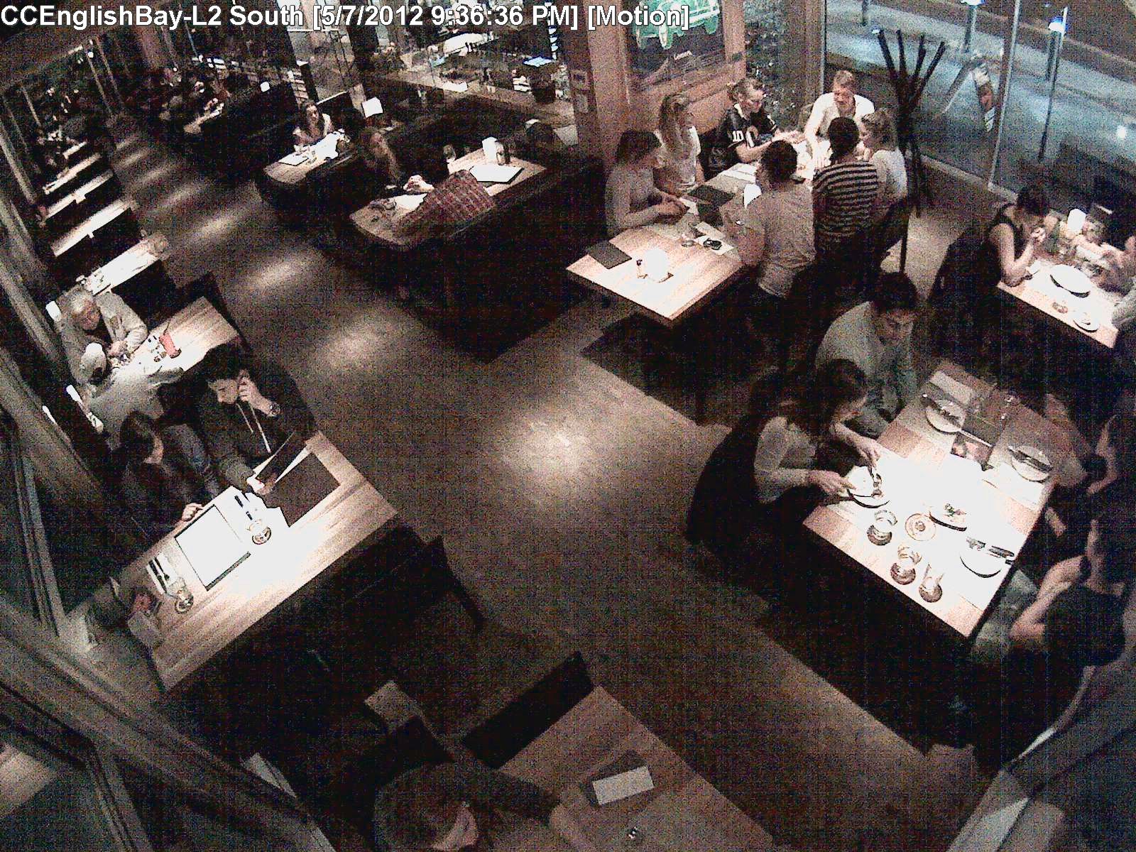

Those are a nice little camera, give really good picture with decent lighting, but not so good in low light. If you have good motion-activated floods they'd probably be alright (I haven't tested that). The second camera in Jason's examples is probably better for low-light; I believe that's a 3xLOGIC VSX-2MP-VD or 2MP-D2? We've used the 2MP-VD model in a number of low-light restaurants and been pretty happy with them for the price (there's definitely better out there, but you pay quite a bit more).

I sent you a PM about 3xlogic...let me know if you did not get it. Also, take a look at 3xLogic's web page, they have the cameras we have mentioned. They also have a full demo of their cameras/remote software from Colorado which is what sold me on their system since I was able to view live cameras, play back footage, initiate camera control (PTZ).
Attached is a night shot from their VSX 2MP VD (vandal dome) - bear in mind there is a lot of lighting at that location
