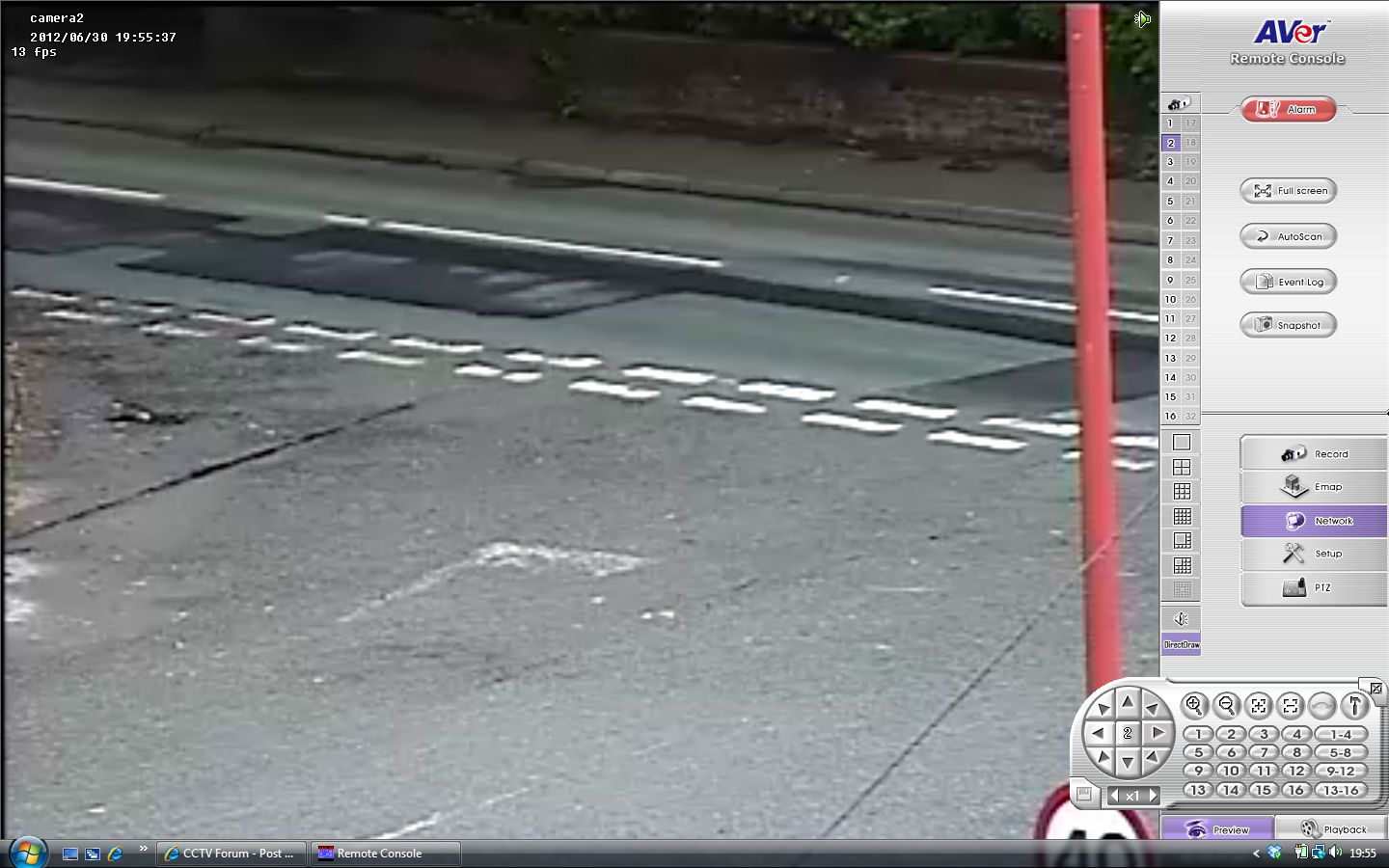

andyh747 0 Posted June 30, 2012 hi andy. am 80mile from the unit. i think i see your problem. you cant enter ptz menu direct from dvr you have to be on remote viewer .... have you tried that ? Thanks again for your reply Tom. I hadn't tried Remote iViewer so had a go with that. Just to be sure I'm doing the correct thing here's what I tried. Loaded Remote iViewer on PC Selected the PTZ camera so it displayed in the main window of iViewer. Clicked on the PTZ button. Pressed 1 followed by 1 within 5 seconds on the PTZ control popup. Unfortunately nothing happened except the camera went to Preset position 1. Tried it with keyboard numbers as well but these didn't work. Any other suggestions? If you're willing I could PM you a login so you could try from where you are just to be sure. Share this post Link to post Share on other sites
