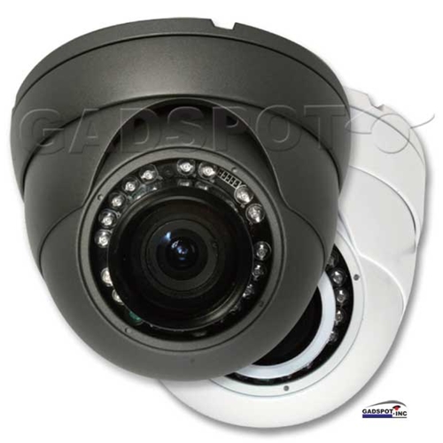

Now put that all together in something like a gadspot GS830SM, and you have as nice camera for your situation-
