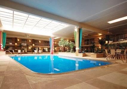

ssnapier 0 Posted June 18, 2012 The customer owns a hotel and this hotel has a large indoor pool. The pool closes at 9 or 10 pm, but he has people sneaking in there after hours and using the pool. Apparently they are doing much more than just swimming too. He specifically asked for a camera to watch the pool, but he wants it to be inconspicuous. The pool area is not very well lit, and he has cameras covering the walkways aroudn the pool, but the pool itself and the 15 feet around the pool are basically unlit. There is a GIANT skylight above the pool so during daylight hours there is plenty of light, but after sunset there is pretty much just light on the walkways and thru the breakfast area (which is near the pool in a shared open space). That skylight also prevents me from just putting a camera on the ceiling. When I originally put cameras in this place he told me that he had liability concerns with putting cameras on the pool itself so we made sure that no camera would have any chance of seeing the pool. Now (over a year later) he has changed his mind and wants it covered, but he only wants a single camera. I am using a Mobotix D-12 for this, so I have two lenses to work with (one day sensor and one night). EDIT: I should also mention that this is in the center of the hotel and the rooms all have a sliding door that leads directly out to the pool area walkways. The second floor has a balcony overlooking the pool area too. Here is a picture that might help: Share this post Link to post Share on other sites
Soundy 1 Posted June 19, 2012 Put a couple good TDN non-IR cameras on the bottom of the pool and just leave the underwater lights on at night. Share this post Link to post Share on other sites
ssnapier 0 Posted June 19, 2012 The pool does not have lights (which is kind of crazy) or that is the route I would have taken. Share this post Link to post Share on other sites
SublimitySam 0 Posted June 20, 2012 I know little about IR but I am an advanced ametuer photographer (of visible light) and to see "into" water, or to reduce reflection off the surface, I would slap a polarizer on the end of my lens. Of course that reduces the amount of available light by up to 1 1/2 f stops. i'm not sure why your customer needs to see "into" the water but a plolarizer might help if they do. Share this post Link to post Share on other sites
ssnapier 0 Posted June 20, 2012 After a lot of discussion I have finally gotten him to understand this a little better. He no longer wants to "in the water" view, but he wants me to expand my view of the surrounding area, which means one or two more cameras... baby steps are better than none! Share this post Link to post Share on other sites
