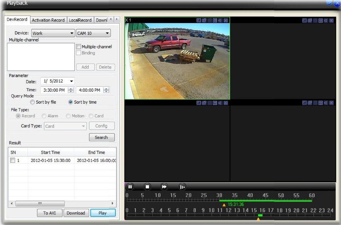

It does not have a thumbnail search, but as far as a day and hour timeline, it does have that. It has it both at the console as well as the PSS remote viewing software. If searching with PSS, be sure to search by time as opposed to search by file. Specify an entire 24 hour period. You will then be shown all of the recording events for that day. You will have the 24 hour timeline at the bottom and a more precise hour timeline at the top:
