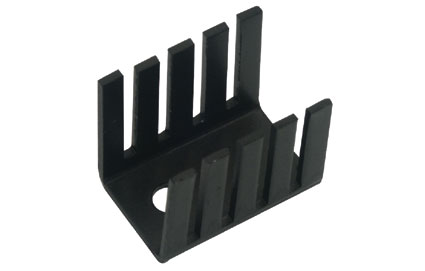

Also, if it's going into thermal shutdown, that indicates there's not enough cooling. I wouldn't run more than 100mA through one of those without SOME sort of heat sink attached, even if it's just a little piece of aluminum that's not attached to anything else:

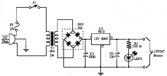

NotoriousBRK: I apologize for not being clearer on the schematic that this site provided. It was very close to the schematic that “Soundy” provided for us to review.

Soundy: I think you posted a reply to another newbie that illustrated the schematic I followed. That schematic only showed ½ wave rectification, but I went ahead and went full wave (I have all these parts laying around just wanting to do something interesting!)
