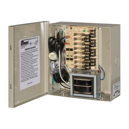

So does anyone know if I wire up the cameras using cat5 and then use CNB connectors on the ends to plug them into the Aver Nano, whether this will power them?

hi. Dave. no DVR will only do video ... for power you will need to either install a local power supply (same area as camera) or use a multi output unit .... this can be installed along side your dvr.
Oh, that's annoying.
So it's either buying that box, which looks like its about £50, and then running Cat5, or I need a nearby plug.
Wouldn't it be cheaper and easier to just run an extension lead to near where the camera is? Are there any downsides to that?
hi. no it would cost you more extention lead then 12v power supply
hi. lead kits are never a good idea.
even if you use a lead kit or a reel of cat5 with baluns the work involved with installing them is the same.

Okay, so a multi out if they way to go.

okay, so lead kits are wrong and I need a multi outlet with Cat5. I think I'm starting to get my head round this.
