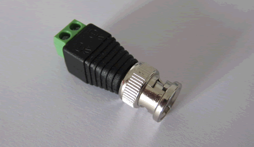

if you have not paid much for your cameras. then you will not have spent enough on baluns.
do you have True cctv baluns or are you using these from ebay. i know ebay list them as baluns but there not.
also if baluns how many pairs are you using ???

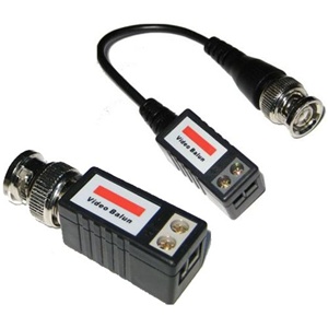

I was ordered baluns like that you put a picture of it, and i suspected it was a problem with a balun, i dissambled it and there's nothing in it..
- new balun which i'm using it now - A REAL with with coil inside
On the photo at top (with wire)
But almost same problem - interfections decreased a little bit..

Edit: forgot to mention: i'm using 1pair (2 wires for connecting a balun, same color for + and - on both ends)
