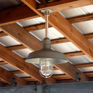

vector18 1 Posted July 11, 2012 Your typical installer uses beam clamps, 1900 boxes, etc. I like installing a 2x4 across the ibeams, mounting a base plate to the 2x4 and thread conduit to the base plate and than threading the conduit to the camera base to a vandam dome. Or, if the ceilings are not too ridiculous high, why not go with varifocals and zoom in? Share this post Link to post Share on other sites
vector18 1 Posted July 11, 2012 Something similar to this, but the wood is laying across the ibeams........ Share this post Link to post Share on other sites
