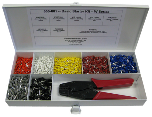

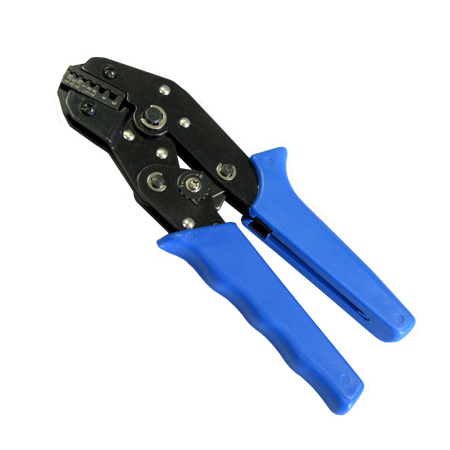

Numb-nuts 1 Posted July 13, 2012 Cat5 cable was never designed to work with screw down terminals. The way I deal with this is using 0.25mm chord end ferrules crimped onto the stripped end, trimmed if necessary and set into the the baluns. No amount of moving the cable will cause the connection to fail. I use ferrule ends on all screw down connections and they just never fail. Invest in a good crimp tool either plier or ratchet operated, they are a great way of solving the problems you describe. Try searching your search engine for Ferrules Direct (in US), you should use the insulated ones as they tend not to allow the wire to break, and be prepared spend around $45 on a good crimping tool, with the range 24 to 10AWG (0.25 to 6.00mm2) 0.5 mm ferrules will work with both cat5 and with cat6 cable and you can use stranded cable too. I would put a link to the best supplier here but they will simply remove the link (so why should I bother). Further, if you make any connections in a junction box outdoors, smear the contacts with Contralube to protect from corrosion. I have the blue tool shown below and it's great. One of the cheapest ratchet controlled tools around and does the job without any trouble @ around $44 Share this post Link to post Share on other sites

prinler 0 Posted July 14, 2012 I use the Cat5e connectors from Homedepot. They are just like the rest of the ice cubes i have always used in my life. I have done maybe 5000+ cat5 ends. I have little failure rate. I will take all your advice and use it the best way i can. Gonna try different baluns and crimp those ends on and screw down. Can you tell me what kind of cable you use? Previously i would just goto CED and get there 1000' box for $99. I had a failure last pull last house so i opted for the more expensive indoor/outdoor tan from Homedepot 500' for $70.00. It seems thicker and more stiff. It matches most house eves and it seemed to pull easier (less stretch and self kink protection due to the thicker jacket). $70 for 500' tho.... The blue stuff on the reel from CED is so limp but it works for inside applications well. What do you use? where do you get it? How much do you pay? Share this post Link to post Share on other sites
groovyman 0 Posted July 14, 2012 I use the Cat5e connectors from Homedepot. They are just like the rest of the ice cubes i have always used in my life. I have done maybe 5000+ cat5 ends. I have little failure rate. Great. Didn't know you're experience level. That certainly isn't the issue then I have some small suppliers in my area and always bought from them. I always like to support the small business guy rather than the huge suppliers. But, I haven't bought much cable in the last couple of years as these days I don't run much of the cable on the jobs I get. I have a couple of guys who do a great job. I don't need to be the guy up on the ladder pulling anymore - been there, done that & tired of it (and my back thanks me for it ). I'll terminate, mount patch panels, switches, routers, cameras, etc. and configure all the equipment. I can't completely avoid running cable, but I avoid it as much as I can Share this post Link to post Share on other sites
