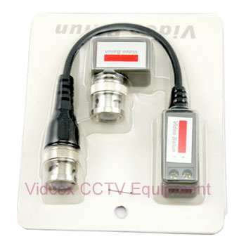

ljarrald 0 Posted June 13, 2013 i use these (but not from ebay) and they work great! best thing is no screw terminals to faff with! Share this post Link to post Share on other sites

Numb-nuts 1 Posted June 18, 2013 ljarrald said: i use these (but not from ebay) and they work great! best thing is no screw terminals to faff with! the ferruls work even better with that type of push fit terminal and so quick Share this post Link to post Share on other sites
