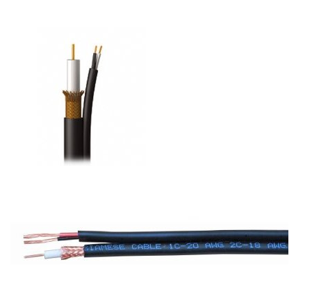

SecurityNub 0 Posted July 16, 2012 I found a specialty store in town that carries quality RG59 cable. It is 4 times as thick, very durable. But I don't know how to link two cameras to one cable. Can anyone link to a nice how to guide? Or give tips on what they did? Or even if it is a good idea? Share this post Link to post Share on other sites
Soundy 1 Posted July 16, 2012 You can do it, but it requires a special device designed for that purpose. If you're buying new wire, I assume that means you don't have any wire run yet - in that case, just pull one wire per camera and be done with it (don't forget a power wire for each camera as well). Keep in mind that just because it's thicker cable, doesn't mean it's better... for best results, it's important that CCTV cable be 75 ohm type (RG59 or RG6 - not 50 ohm, like RG58 cable-TV and antenna wire), have solid copper core (not copper-clad steel or aluminum), and a braided copper shield (not aluminum foil) with at least 95% coverage. Share this post Link to post Share on other sites

SecurityNub 0 Posted July 17, 2012 You can do it, but it requires a special device designed for that purpose. If you're buying new wire, I assume that means you don't have any wire run yet - in that case, just pull one wire per camera and be done with it (don't forget a power wire for each camera as well). Keep in mind that just because it's thicker cable, doesn't mean it's better... for best results, it's important that CCTV cable be 75 ohm type (RG59 or RG6 - not 50 ohm, like RG58 cable-TV and antenna wire), have solid copper core (not copper-clad steel or aluminum), and a braided copper shield (not aluminum foil) with at least 95% coverage. It's RG59 with solid copper core, I'll check the other two things you speak of. So I currently have VideoSecu with power supply connectors already attached. I saw online RG59 with 2 copper wires for power supply, but no connectors already attached.........Is it difficult to do the attachments myself? Like this? And are you saying I should just run two of these along side each other rather than have one cord for all? Rg59 Solid Copper Core Braiding Copper Shield 95% coverage? What is 95% coverage? Share this post Link to post Share on other sites

jeromephone 6 Posted July 21, 2012 run one of the cables depicted in the pic for each camera label them on both ends. That will make trouble shooting down the road that much easier. The last thing you want is another connection aka point of failure, in some hard to get at place. Compared to the cost of the project one more cable run is nothing. Share this post Link to post Share on other sites
