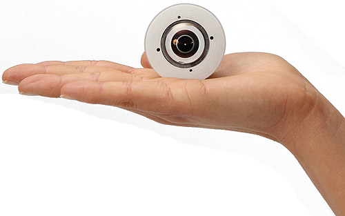

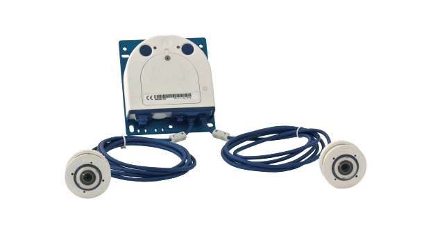

buellwinkle 0 Posted July 17, 2012 Have you looked at the new Mobotix S14. The camera is a small box you hide somewhere, the lenses are on 6' leashes and are pretty small, one for daytime color that is 3MP and one that is 1.2MP b&w. If you can build your home it so the camera box is inside the wall, in the attic, somewhere you can get to it if it needed servicing, then recess the lenses in the wall or sofit for a clean look. The lenses are small, maybe 2" diameter. The night sensor on Mobotix is best I've seen for low light viewing and the color 3MP, it's a nice crisp clear image. I know you will be shocked at the price, but consider that you don't need an NVR or PC with NVR software as it's built into each camera. Share this post Link to post Share on other sites
ptr727 0 Posted July 17, 2012 Very nice, but like you said, quite expensive. I'd love to see a review Share this post Link to post Share on other sites
