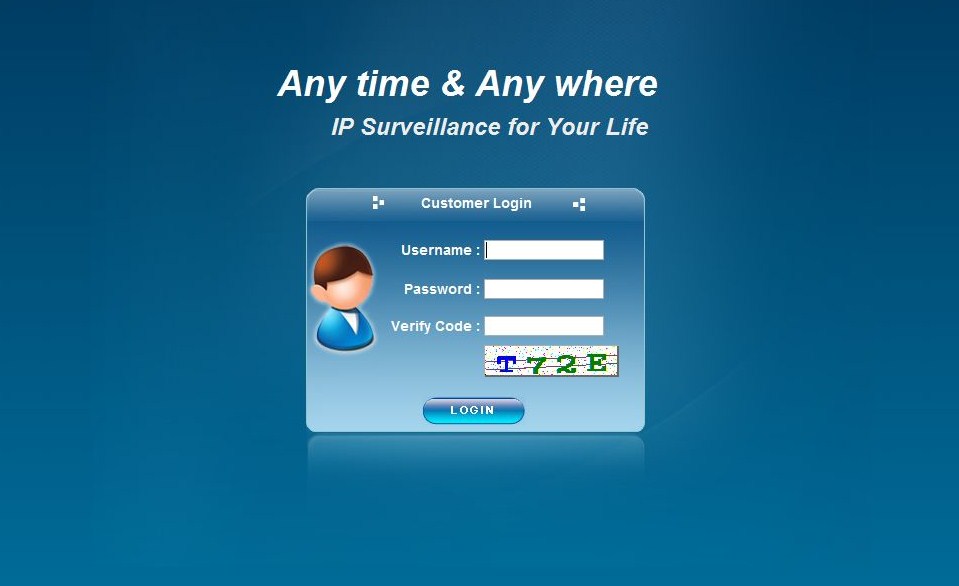

white_comet 0 Posted July 20, 2012 Hello guys, i'm from the Philippines and i'm having a problem with regards to my cctv ip address.. using lan (192.168.254.11:80) i have no problem accessing.. but i can't access my cctv ip address (120.28.88.65) when i'm out (remotely?). I'm using avtech H.264 8ch dvr and using globe broadband modem/router prolink H6300G. I don't know if i did the correct thing configuring the port forwarding as i read a thread here giving instructions on how to port forward. Btw, i'm using a static ip address. I've been stuck here infront of the computer and the cctv system for 2 days now. Please help me thanks very much Share this post Link to post Share on other sites
