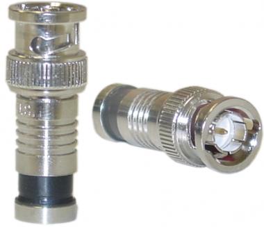

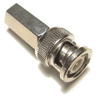

You will need a twist on BNC video connector or compresion type like this:
Twist on:

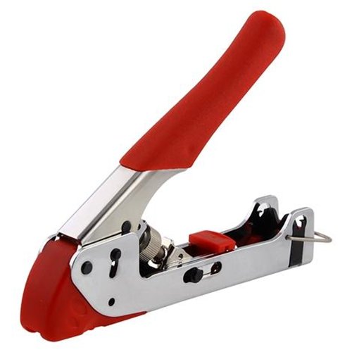

...and a tool like this to compress the connector onto the video wire (make sure the wire is RG-59 and you get the corresponding connector:
