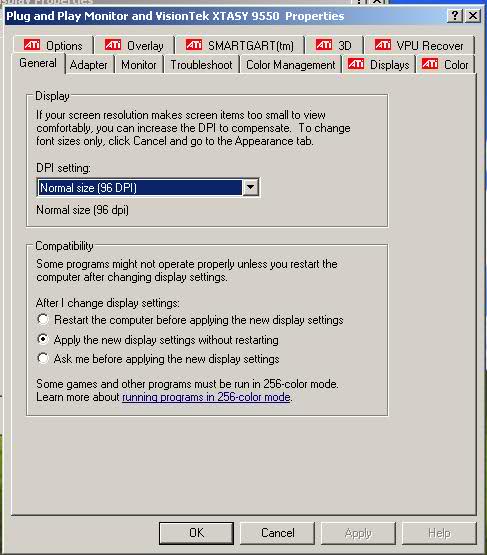

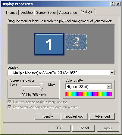

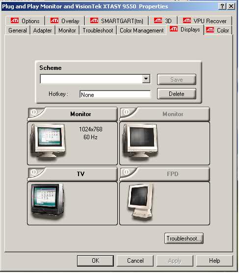

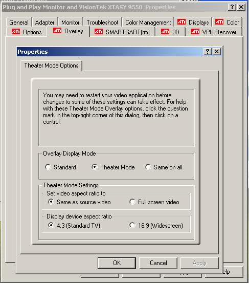

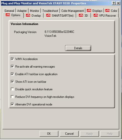

Rahul1023 0 Posted October 8, 2005 I don't know which settings you wanted so I took screenshots of all of the relevent settings which I messed with on the ATI settings panel. I haven't touched Hydravision, so if you think I need to adjust that, please let me know. Share this post Link to post Share on other sites
rory 0 Posted October 8, 2005 Have you tried selecting dual displays in the Scheme section? Rory Share this post Link to post Share on other sites
Rahul1023 0 Posted October 8, 2005 Thanks for searching on ebay for me CCTVDude. I looked into the auctions which you found, but a couple of them are UK models, and one of them has an international plug. So that one is out, the other ones don't mention whether they have BNC connections or not, Is this a standard? Also would I need T connectors and more BNC cabling to wire back to the DVR, or would I be ok with any of these units? They sure are cheap though... I found a multiplexer online for about >$400. Thanks again.. Share this post Link to post Share on other sites
Rahul1023 0 Posted October 8, 2005 there is no option for dual display under schemes... There is only "Default Single Display" and "Switch amongst displays" Share this post Link to post Share on other sites
cctv_down_under 0 Posted October 8, 2005 Download the latest drivers from ATI, from memory they are called Detonator Drivers, make sure you are plugged into both before you start up the computer and you should be able to use both views, do not use extended view of desktop, use clone view, but your DPI on the analogue will make it look poor and it is a conversion so you may not be happy. Using VGA splitter limits distance unless taking advantage of very good quality cable and gold connectors etc, I would use the quad or cheaper still a looping switcher to get your result, you can not run far from the ATI card if you choose a VGA card option. Share this post Link to post Share on other sites
