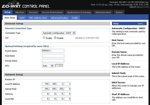

JimS 0 Posted July 30, 2012 Perfect candidate for DD-WRT. I swapped my NetGear for this. "WRT54GL Wireless-G Broadband Router with Linux Firmware" Based on the description and model number, I thought it already came with the DD-WRT firmware installed. http://www.microcenter.com/single_product_results.phtml?product_id=0302906 When you're in a router with DD-WRT firmware, is there an obvious way to see that? I've spent literally all day today just trying to make the wireless work. I've tried every combination except for the correct one obviously! It connects with excellent signal strength but it never authenticates. Share this post Link to post Share on other sites

buellwinkle 0 Posted July 30, 2012 You would know if you were using DD-WRT as it would say so in the menus. Share this post Link to post Share on other sites
JimS 0 Posted July 31, 2012 Thanks for the screen capture. That's not what I have. Somehow my ebay searches for pre-flashed routers (like you recommended) turned into Google searches, that ended with me rushing off to MicroCenter for the WRT54 router. I let the Linux verbiage in their ad and the WRT in the router name fool me. Now I'm doing the required reading to do the DD-WRT upgrade. We'll see if I know how to read and follow directions in a few days. Maybe then the wireless will work with the laptop and the camera. Thanks for all the help. Share this post Link to post Share on other sites
