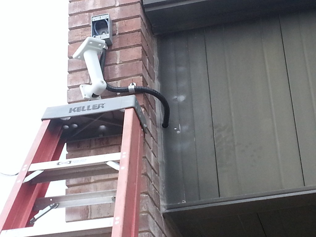

sbwhite0 0 Posted July 27, 2012 I'm trying to mount 18 axis 3314e exterior cameras on a block column. I want a clean and funtional installation, but I'm having some issues. I have attached some photos. Any help would be greatly appreciated. I couldn't get the picture to attach so I've linked it below. Any ideas how I could clean it up some? I don't really like the way the seal-tite is laying. My boss said something about mounting it on some jr. stut. I think that would look even worse. He also suggested EMT conduit, but again I think it would worse. I'm betting one of you professionals could probably take one look at this and tell me how you would make it look slick. Share this post Link to post Share on other sites
vector18 1 Posted July 27, 2012 Why not get a long masonary bit and blast through the brick so all you have is the camera mounted? Share this post Link to post Share on other sites
the toss 0 Posted July 27, 2012 pvc conduit with elbows would look nicer going around that brick pillar Share this post Link to post Share on other sites
sbwhite0 0 Posted July 27, 2012 Thanks for the tips. I ended up using a 36" masonary bit at an angle to get me directly inside. Then mounted the camera directly on the brick with tapcons. Looks great! I will post some pics on Monday of the finished product. Again, thanks for the ideas. I guess sometimes you just need a longer bit. Share this post Link to post Share on other sites
