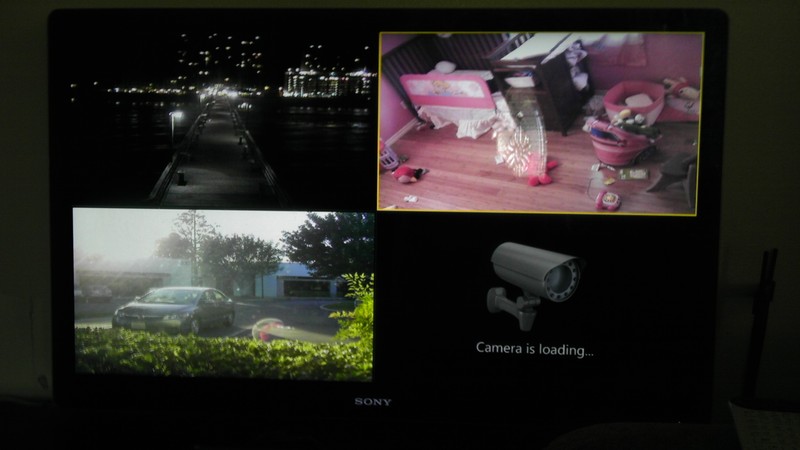

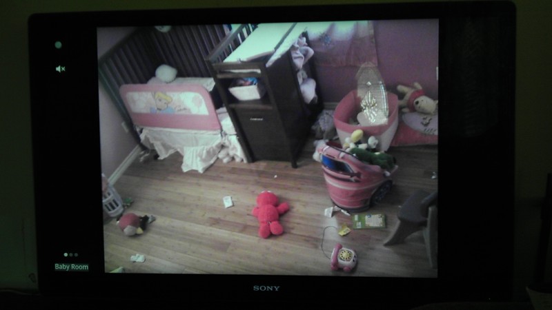

vin2install 0 Posted July 30, 2012 Vizio has a device called a CoStar for $99.00. I have an integrated google sony TV that i use to stream live using my ip cameras using an app called Tiny Cam Monitor. There are many other Google TVs out there too Share this post Link to post Share on other sites

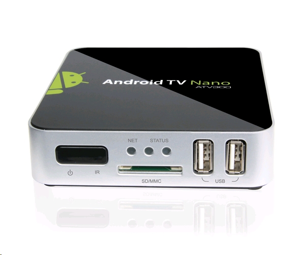

Soundy 1 Posted July 30, 2012 I picked up a little Android media player for $89, does the job as well - same "IP Cam Viewer" app as on my phone. Share this post Link to post Share on other sites
vin2install 0 Posted July 30, 2012 Vizio CoStar says it's "coming soon". Does google TV support Android marketplace apps? I thought it was available already, but i guess not yet. Sony has a 200.00 google media player available but i think that is kind of pricey. I had mine Sony integrated google tv for almost 2 years now. You can find the logitech revue for pretty cheap under 100.00. It does support the android marketplace to download apps but the selection is still limited at the moment. Share this post Link to post Share on other sites
