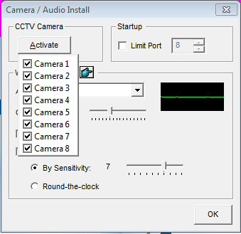

I'm trying to add 2 new cameras to my existing GV-800 setup. I currently have 8 cameras installed and am trying to add 2 more (all bnc cable cameras). The GV card has 2 VGA slots, one labled 1-8 and the other 9-16. I recently purchased a new blue cattail cable to support the 9-16 slot. I plug in everything correctly but dont see any of the cameras registering on the software.
I go to the add camera/audio settings on the geovision 8.4 software and am not able to check any 9-16 camera option. The limit checkbox wont let me go over 8 either.
The new cameras all work, i tested them with one of the existin 1-8 ports and the new cables as well.

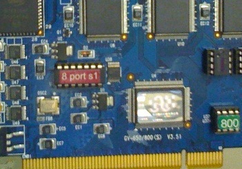

Sounds to me like you have a GV800/8 card
only 8 channels...yes i know there is another "VGA style" socket with 9-16 on it but all 8+16 Channel GV cards had this
Open the PC and look at the GV800 card, there will be a chip with a label saying 8 port or 16 port

Thanks for your quick response Neutech. So the only way to add the new cameras is to purchase a new card that supports 9-16 CH ?
What kind of scheme is it to put the 9-16 vga on the back.
Simple: a cost-saving scheme. It's cheaper to make two different cards using the same basic hardware (board, connectors, etc.) than to have two different designs.
Either a second 8-channel card, or upgrade to a 16-channel card...
