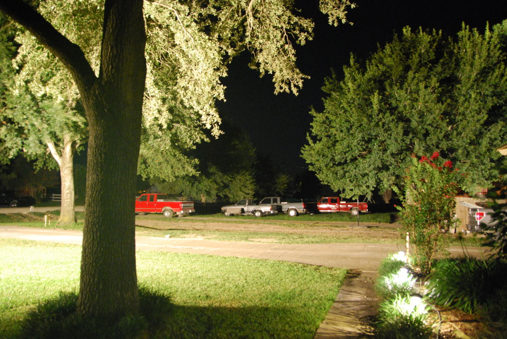

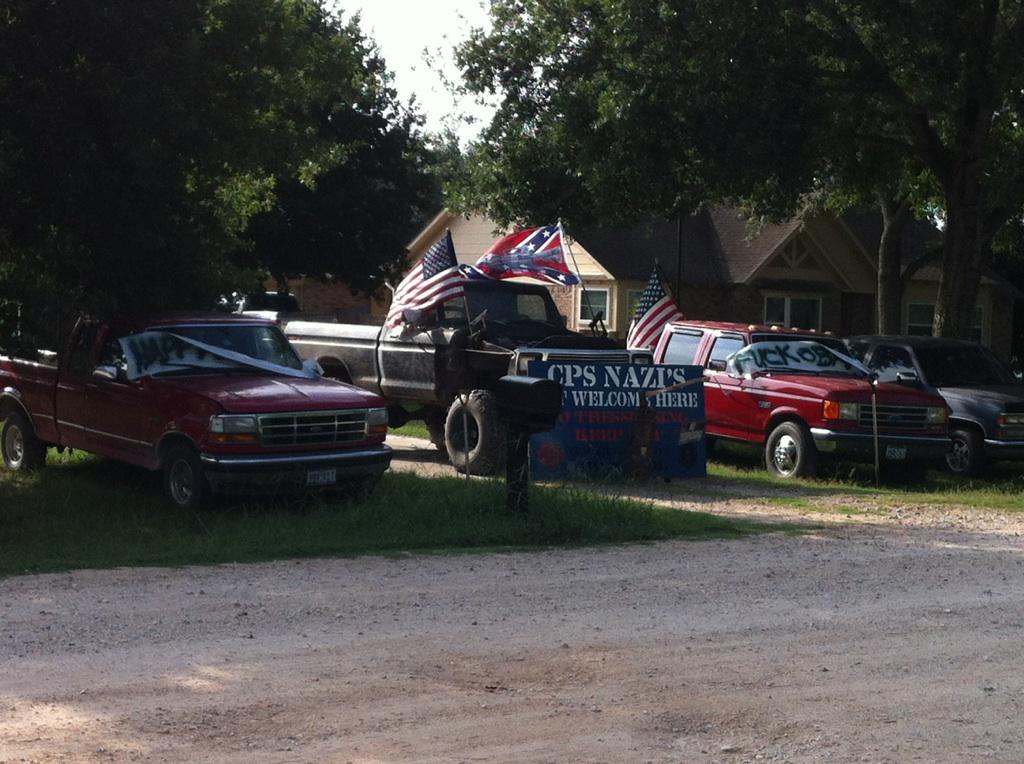

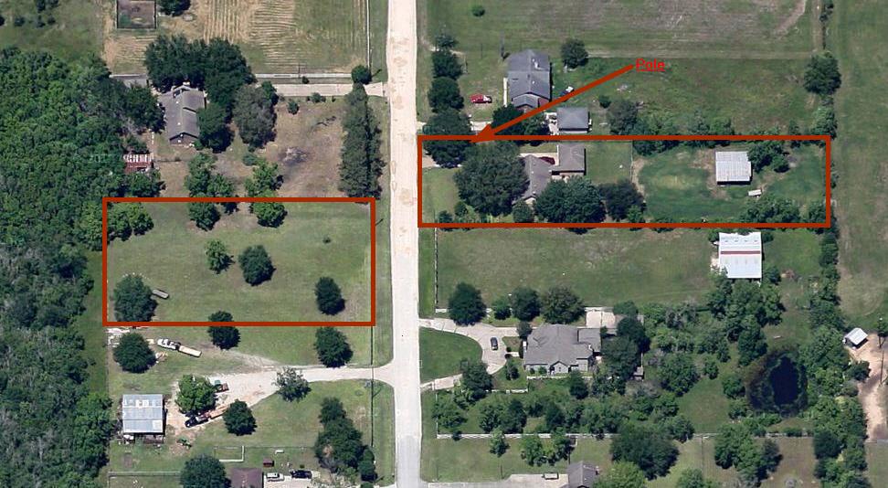

FATHERFORD 0 Posted August 14, 2012 First let me say great forum with lots of information. In my case it seems to be to much as the more I read, the more I get confused. I have setup the cheaper sams/costco units before, so I am familiar with the low end/budget setups. I just recently moved to a new location for more of a country life style. My parents bought the land across the street from me to build. The road in front of our houses is private(we the home owners actually own the road). We also will be building a 40x60 shop behind my barn for personal and small business. There are a few reasons for me wanting a high quality CCTV system: 1. I have caught my neighbor(the one north of my location) TWICE "borrowing" things from my barn. He still owes me money for 25 gallons of gas he borrowed from me 2 months ago. I also discovered he does have an arrest record(one within a year) and does other questionable activities. He refuses to work and thinks drinking beer and playing in a mud pit in his back yard is more important then paying be back for the gas he "borrowed." Btw...this is something he is proud of 2. There is NO reason for anyone to be driving down our road unless they live on it. Not only is our road one of the very few left that is dirt/gravel, our road on either end leads to no where. I have been seeing a lot of suspicious traffic that doesn't belong. 3. The previous two lead to my main concern.. My parents and I will have building materials on both properties in the coming months as they build their house and as I build my 60x40 building in the back of my property. I would like for their to be some surveillance not only for things potentially being stolen, but to also watch the build process when no one can be there for the day. Which leads me to where I need y'alls help to spend my money. In the following picture the right square is my current property, and the left square is the property of my parents land. There is a light pole that can not be seen in the pictures, but gives great view of my house and the front of my parents property. I'm looking to purchase a decent high quality picture DVR and at the moment two High Quality cameras with plans to add more in the future. One camera that I can face towards my parents property, and another that will face towards my house. I would like to eventually add at least an additional 6 cameras to the house as time goes by. I don't have an unlimited budget, but I'm willing to spend a little money up front for a good DVR($300-400) and two good cameras(night vision?) If the DVR has PTZ control even better! Where to buy would be a bonus! I'll keep reading waiting for response. Share this post Link to post Share on other sites

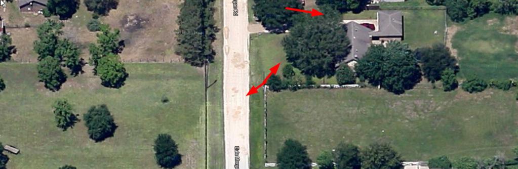

FATHERFORD 0 Posted August 23, 2012 Digiscan said: Quote playing in a mud pitI have to know, what exactly do you mean by this? Does he drive a truck around in the mud? Fling it like a pig? Sorry I can't opine on the cameras, but your neighbor sounds interesting. He has a big mud truck he drives in a pit in his back yard... So I'm starting to decide on a few things... AVerMedia Hybrid 16 Port NEH1116H VideoSecu 18 Output 12 V DC CCTV Distributed Power Supply Box 2x1000ft rolls of Siamese cable As far as location: The Top camera will be mounted 15' high on a light pole. The bottom two cameras will be mounted on my power pole 15' or so high. I do have flood lights around my house that are motion sensor already. A coworker is using Vonnic cameras and seems to be happy with them. Is there a better suggestion for the price range? Share this post Link to post Share on other sites

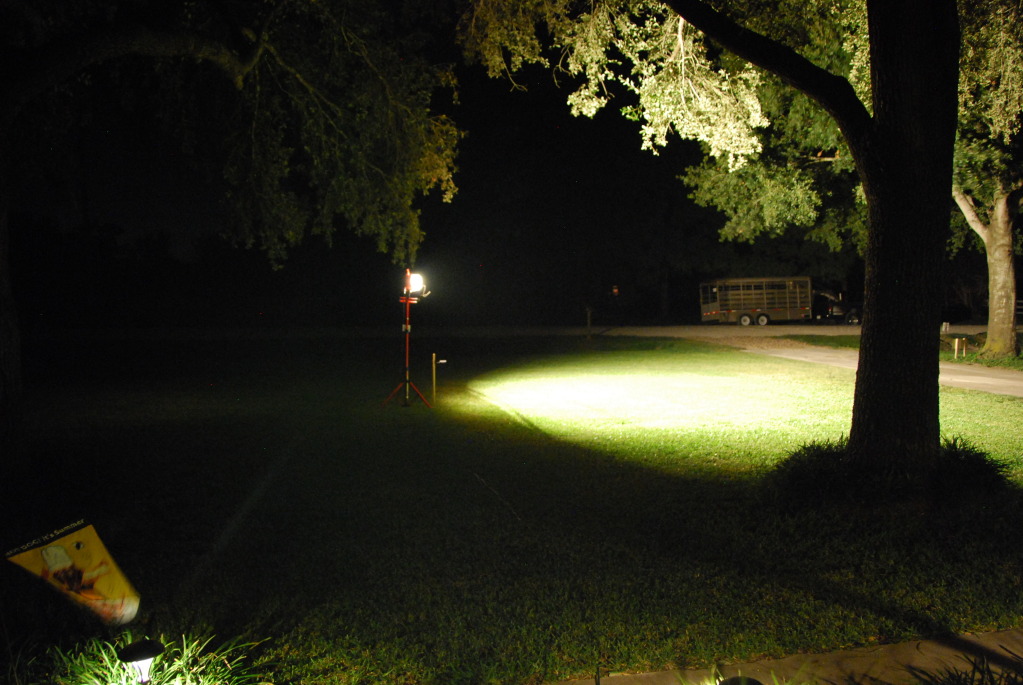

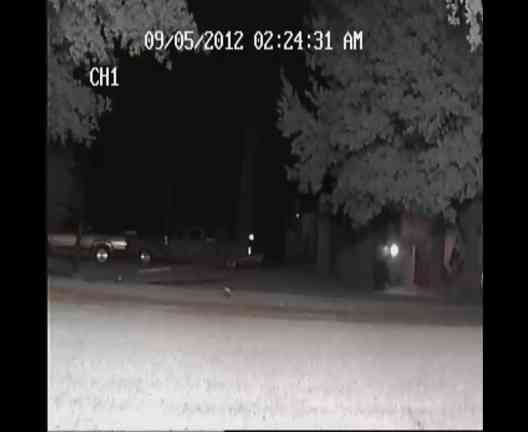

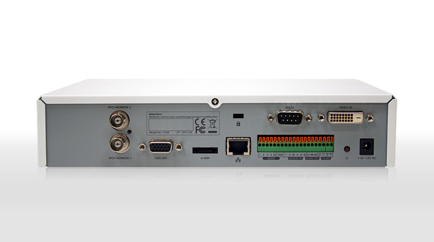

FATHERFORD 0 Posted October 15, 2012 Kawboy12R said: Awesome! Turned out much better (so far) than I was expecting. I wonder if he has started lining his windows and hats with tinfoil yet? Back on to cameras though. Do you have any comparison pics or video? Preferably at night with someone walking up to the camera? I can try and get some vid/pictures. I do have one of the night owl where he saluted me/camera after he lost the "light" war. I had many more lights up, these are just some sample pictures. First I need to say that it did get worse before the setup got here. The AVER DVR was delayed, and before it got to my house he decided to destroy my light pole by running it over with his truck(destroying the fender of his truck in the process). Cops called etc. etc. So I immediately went out to Fry's and bought a NightOwl 8 camera system. Threw it up real quick until my good setup came in. To the Cameras: I just figured out some of my problems and the power supply I'm using just can't push the amperage needed. When all the cameras are hooked up(8x of the night owl, the CNB's, and the VideoSecu most would just flicker off. I was having major problems with the CNB VCM-24VF. So much I returned one thinking there was something wrong. They would click on and off several times, and sometimes make the other cameras flicker. The power supply only has 10 amps total, and max of .5 amps per channel. I tried hooking the CNB up to an individual .5amp power adapter that came with the VideoSecu cameras and it would still flicker. I hooked up a 1.5amp power adapter that came with the night owl setup I bought and It works flawlessly. All the other cameras would work now, but at night when the IR came on they would not be as bright, and there were lines going through the cameras. When I took the other CNB bullet camera and the VideoSecu and placed them on their own power adapter all the problems went away. I now ordered a new power supply box that is 29amps total, and max of 2 amps per channel. I'm hoping this will resolve all my problems. I have to think there is enough of a drop in power using 65'/100'/150' cables that the ViewSonic Power supply box couldn't keep up. Camera opinions: Night-Owls: Cheapos that get the job done. They are great for places where you just want to watch movement, but not identify anything. The microphone sucks on them. CNB VCM-24VF: I am so far not that impressed. Great build quality, but as far as picture quality goes I don't think it's that much better then the VideoSecus at half the price. I have one on my front porch where I have a dimmed/motion sensor porch light, and where my cars are parked where I have a security light that comes on at night. I'm sure I could work on the adjustments so more. CNB WCL-20S: I have this one mounted about 10' in the air on the side of my house, looking down the entrance to my driveway. Looks pretty good during the day, and at night looks great with my "New" light pole. I can't identify faces with it, but I can clearly see what is going on. I've read some people claim they are rubbish, but from between the VCM-24VF and WCL-20S I prefer the WCL. VideoSecu 700TVL: The first one I installed I thought it was rubbish. I had it looking out over my back yard and the back acre. Look great during the day, but not worth a damn at night. The next one Installed to look at my back porch(35'x15') and it was absolutely brilliant. During the day and best looking camera at night compared to all the others. A little grainy, but I could clearly see what is going on, and even see my dogs face. I placed the first camera wrong and that was the only problem. I ordered two more VideoSecu's as I'm impressed with them that much. I also ordered one more CNB WCL to hang in another location. Aver DVR: I have only had limited experience with CCTV DVR's, but this is by far the best I have ever dealt with. It is a very professional feeling setup, and the remote interface is absolutely gorgeous. On my android phone I'm using IP Cam Viewer and it works flawlessly. The 3tb hard drive slid right in and formatted. I can record nearly a months worth of video at D1 before it starts repeating on itself. Also coming in: I have a Clarion VA700 Video Distribution Amplifier coming in to split the spot monitor feed so I can see the cameras all over the house. It uses the power source off the CCTV power supply box. I'm hoping this will work as I hope. Needs: I'm looking for a pigtail that I can plug into the back of the DVR for the audio. Where can I find such a beast? Share this post Link to post Share on other sites

Kawboy12R 0 Posted October 15, 2012 I can't help on a pigtail. Looks like a bare-wire audio hookup to me, like the pinch-to-connect hookups for home theater speakers. I'd buy the cables I wanted with RCA connectors on one end and cut whatever's on the DVR end off and insert the wires into the pinch connectors on the DVR. That'd be a bit Mickey Mouse with 4 grounds going into one pinch connector though. An Aver dealer might have something fancier with 5 bare wires and 4 female connectors to use for audio. What cameras were used in the pics you posted? Looks like nice quality with good colour in the second two but then you've got lots of light. Much better recorded video quality than my cheapo DVR does. I've been wavering on getting an Aver or not, with some positive reviews and others not quite so impressive on here. Share this post Link to post Share on other sites
FATHERFORD 0 Posted October 15, 2012 Kawboy12R said: I can't help on a pigtail. Looks like a bare-wire audio hookup to me, like the pinch-to-connect hookups for home theater speakers. I'd buy the cables I wanted with RCA connectors on one end and cut whatever's on the DVR end off and insert the wires into the pinch connectors on the DVR. That'd be a bit Mickey Mouse with 4 grounds going into one pinch connector though. An Aver dealer might have something fancier with 5 bare wires and 4 female connectors to use for audio. What cameras were used in the pics you posted? Looks like nice quality with good colour in the second two but then you've got lots of light. Much better recorded video quality than my cheapo DVR does. I've been wavering on getting an Aver or not, with some positive reviews and others not quite so impressive on here. Oh sorry, the light pictures were taken with a real camera. Not a CCTV setup. Share this post Link to post Share on other sites
