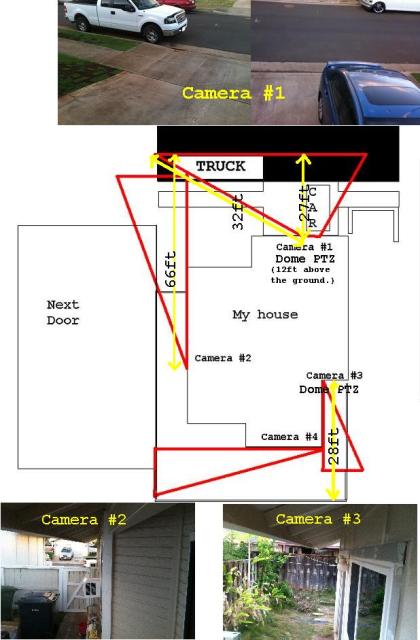

unsportsmanlike 0 Posted August 20, 2012 Hi, All and any information welcomed. I am looking to setup a 3-5 camera system. Primary to catch the kids damaging my fathers truck on the street. Diagram with pics below. I lived here for 10+ yrs and no problems until I got new neighbors moved in to my left. They are the only kids who play around the truck and in front of my house. I jus need video proof to call the cops or talk with their parents. If i was crazy I would jus shoot them! Any ways my plans are for 2-3 cameras for now and upgrade later d/t budget. I plan to also make a new pc, get a switch and connect to my wireless router. What specs would I need to make a good NVR for my needs? Everything from motherboard to case to hds, etc. Wondering what cameras would be best for day and low light to complete darkness. In the front of house in driveway and street (camera #1) there is a street light. Side of house (camera #2) there is no light. Wonder if 1-2 MP cameras are good from my needs. In the front i would like PTZ camera and back of house. Some features I am interested in: email/SMS pic when motion detected from camera, control/view cameras from my iPhone. Thanks in advance Share this post Link to post Share on other sites

securicorp 0 Posted August 20, 2012 i would recommend analysis of the lens as well. 4mm is best for that sort of view or even 3mm. spring for the mp, it will be worth it. go IP, try a clould system - will save the hassle on onsite recording issues and maintenance Share this post Link to post Share on other sites
unsportsmanlike 0 Posted August 20, 2012 i would recommend analysis of the lens as well. 4mm is best for that sort of view or even 3mm. spring for the mp, it will be worth it.go IP, try a clould system - will save the hassle on onsite recording issues and maintenance so you suggesting a 4mm camera for my camera #1 in my diagram above? also what is a cloud system? sorry i am a newbie... thx Share this post Link to post Share on other sites
securicorp 0 Posted August 20, 2012 yes, see attached for a 2.6mm view and comparable 4mm. Cloud is recording off site and paying a monthly subscription. if there is a potential of a home robbery usually the thieves will take the recorder, but that is not the main purpose for you. i dont think you need that righ now. Share this post Link to post Share on other sites
buellwinkle 0 Posted August 20, 2012 It depends on how long the driveway is and if you want have facial recognition. For example, with a 1080P camera at 28-30 which is how far it is from my camera at my eave to the sidewalk, I can get facial recognition with a 5mm lens. Wider than that makes for a pretty picture, but someone would have to enter my driveway for me to recognize them. Of course with shorter driveway, you can use a wider lens. As for where to buy Axis, I've purchased from PCRush in LA for a decent price. Even buying wholesale from my distributors doesn't get me much better pricing. From my experience, Axis is liberal on their support. Even camera purchased through OEM that they didn't need to support they did anyway. So get the best price you can. Amazon and B&H are also good sources. As for Dahua, there's on guy on ebay, kkmets1986 , name is Kyle that carries a few models under the Dahua name. There's a couple on the internet that sell under their own brand name and model numbers. My advice is to send an email to Dahua and ask them. Their emai address is overseas@dahuatech.com PS. A 8 camera NVR from Dahua is about $325, supports multiple brands of cameras, may be a better value than buying a PC and software separately, don't know, haven't tried it but worth looking into. Share this post Link to post Share on other sites

unsportsmanlike 0 Posted August 20, 2012 It depends on how long the driveway is and if you want have facial recognition. For example, with a 1080P camera at 28-30 which is how far it is from my camera at my eave to the sidewalk, I can get facial recognition with a 5mm lens. Wider than that makes for a pretty picture, but someone would have to enter my driveway for me to recognize them. Of course with shorter driveway, you can use a wider lens. can you see my picture? hope i did it right? Camera#1 anyways from the camera to the end of truck is 27 feet. the left angle from camera to end of the truck 32 feet. any idea to determine the perfect camera for that application? MP, lense, etc? i still want a FTZ dome so please help me narrow it down. remember i am a NEWBIE LOL! can you change lense? if so how? and do companies include them with the camera? Share this post Link to post Share on other sites

buellwinkle 0 Posted August 21, 2012 Looks like pretty good prices for the Axis cameras and he has a 100% positive feedback, I would do it. It's barely early morning in China now, give it time. As for your driveway. Here's the deal, you have an angle of about 70-90 degrees, that's a extra wide angle lens, maybe a 3mm. Look at my driveway with the Dahua 1080P camera in my blog. The angle works almost right with 3.3mm, the widest that camera can do but you won't get facial recognition at that focal lenth at that distance. To get facial recognition, you need someone's face to be 80-90 pixels tall and I was able to get about 85 pixel size face at about 28' with the lens set to about 5mm, but doing so would not cover an area as wide as what I covered, frankly, it covered just the width of my driveway. For example, in my rear yard where an intruder is more likely to come from, I have 2 cameras to give me the pixel density, 2 viewing angles and coverage I need. So you have three choices, more resolution, PTZ or more cameras. If you go with a 3MP Dahua, the width of the image remains the same, 2048 pixels as the 1080P, but you pick up 50% more pixels vertically, but that lets you see 50% more area covered for the same focal length, the face would still be the same number of pixels tall. This is because one camera is 16:9 aspect ratio the other 4:3. Go to 5MP, and you'll have what you want, but you'll get much lower frame rate and probably much lower low light capability. PTZ to me is the worst choice. First you divide the time the camera see's an area by the number of areas you want to track. For example, if you want it to scan 3 areas, each area would only get 20 seconds per minute of viewing time. If you had a huge area to cover, it may make sense, but if you can have 2 or 3 cameras cover the entire area, it may be the same price as the PTZ, but each covers its area 100% of the time. To me, buying a cheap PTZ is risky because of the all the moving parts that can go wrong. Share this post Link to post Share on other sites
