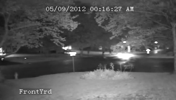

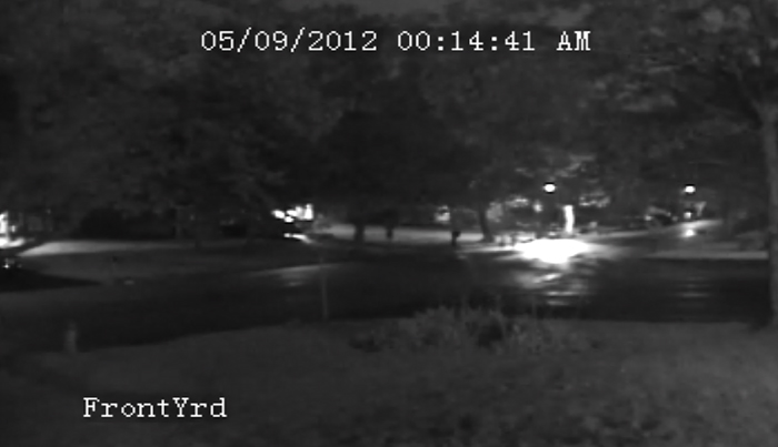

My ptz, an excellent low light camera with the IR off-
Nice noise free picture and will see things even in that low light. But it'll have a hard time ID'ing anyone.
Same camera with it's IR on mid brightness-
THAT will help ID someone. Point being, a 'good low light camera' on it's own with no light support will be a challenge for ID. It's nice to say 'good low light with TDN', but it's not a given that will help at all.
