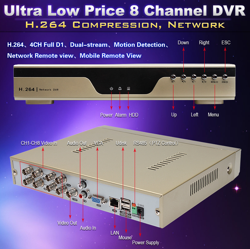

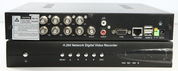

Mr. Anonymous 0 Posted September 1, 2012 I need a 4ch DVR for home use, I only have 2 cameras right now though (live view only). Cheaper the better and I've done a little research... I came up with this ZMODO 4ch 500GB (DVR-H9104UV) for $130: http://www.zmodosecurity.com/4-channel-zmodo-real-time-security-digital-video-recorder-iphone-android-sensor-alarm/ Now I searched eBay only to find tons of generic versions of this claiming to have the same features, all in different boxes/shells it makes it a bit hard to choose. I could get an 8ch generic with the same features as the ZMODO for $80 shipped, any advice?? Share this post Link to post Share on other sites
jakesoundels 0 Posted September 1, 2012 Careful! There is a good chance those DVRs will provide lousy playback images, especially footage that needs to be backed up and handed over to the police. Don't skimp on the DVR. I have a budget 4 channel Dahua DVR and it performs quite well for my needs. I paid around $230 (includes 500 GB HDD). Then, if you upgrade cameras down the line, you will still have a decent DVR. Share this post Link to post Share on other sites
Mr. Anonymous 0 Posted September 1, 2012 I was wondering about that, claims a good frame-rate but does not even mention the resolution/frame size! I noticed all these have a VGA and Ethernet connection. Am I able to view live footage via Cat5 to my PC or "DVR>Internet" "Internet>PC" in other words I have to have an internet connection? Running a VGA cable 2.5 stories upstairs would be a costly pain. Share this post Link to post Share on other sites

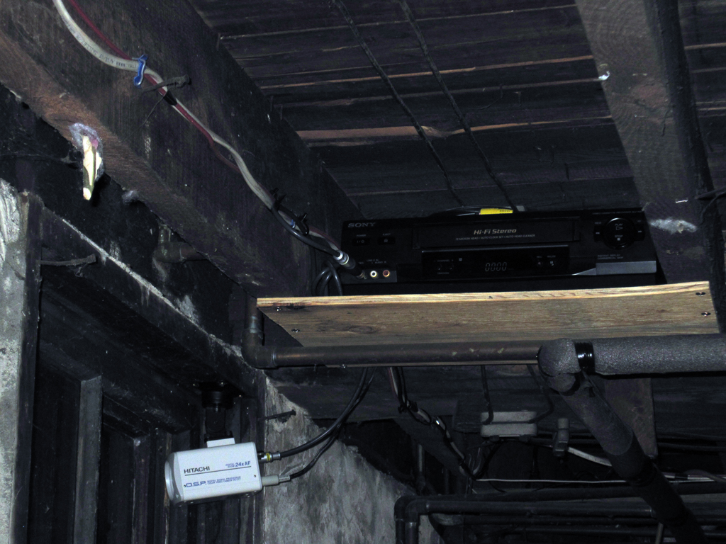

jakesoundels 0 Posted September 1, 2012 You don't need internet to view the cameras on your LAN. As long as you have a switch or any router with ports on the back you will be good. For example, we had a storm the other day and internet was down but power was on. I was still able to view the cams. My dvr is in the basement and I live 2 floors above that and get the cams over the lan via remote software. In fact the dahua remote software is acually better (playback) than the dvr itself. I did have to run cat5 from the basement but I did it on the outside of the house - gheto fab style! Terminating the cat5 is easy, watch a utube vid if needed. Worst case you can run premade cat 5 and use couplers if needed - just tape the jacks so they don't break during the run. Share this post Link to post Share on other sites

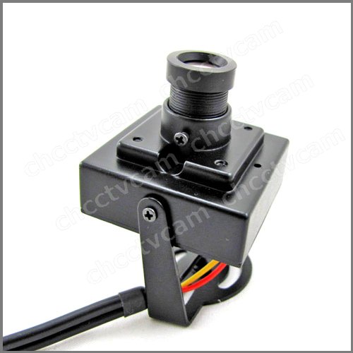

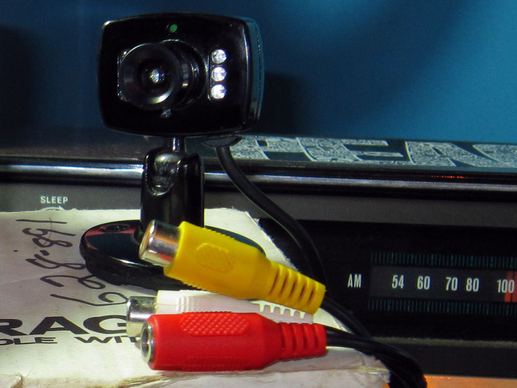

Mr. Anonymous 0 Posted September 1, 2012 So "D1" = 30fps template? Honestly my camera's are not that great, I have an old 1/4"cmos black and white 380TVL Swann Secura Cam (SW214-SCC): I planned on picking up 2 or 3 more but a little better, not sure HOW MUCH better these are. They are 1/3" CCD color 600TVL, resolution 811x508 (ntsc) which is better then the 380TVL 510x492 just not sure how much better: The only camera I have setup that actually takes great quality is my Hitachi VK-C77U: Since I don't have a working system and never did...and don't necessarily NEED one, and money is an issue I might have to start small. The 1/3" CCD's might be sufficient on a budget DVR, and the Hitachi temporarily. Then when I get more Hitachi level cameras I can get another higher quality 4ch DVR, so I'd end up two two separate 4ch systems; one of lower quality. jakesoundels said: You don't need internet to view the cameras on your LAN. As long as you have a switch or any router with ports on the back you will be good. For example, we had a storm the other day and internet was down but power was on. I was still able to view the cams. My dvr is in the basement and I live 2 floors above that and get the cams over the lan via remote software. In fact the dahua remote software is acually better (playback) than the dvr itself. I did have to run cat5 from the basement but I did it on the outside of the house - gheto fab style! Terminating the cat5 is easy, watch a utube vid if needed. Worst case you can run premade cat 5 and use couplers if needed - just tape the jacks so they don't break during the run. So can you can view all channels simultaneously in split screen over the LAN? Do these DVR's record all channels simultaneously as well or just the one you selected? No I would run one solid Cat5(or 6) cable and terminate it myself. Share this post Link to post Share on other sites

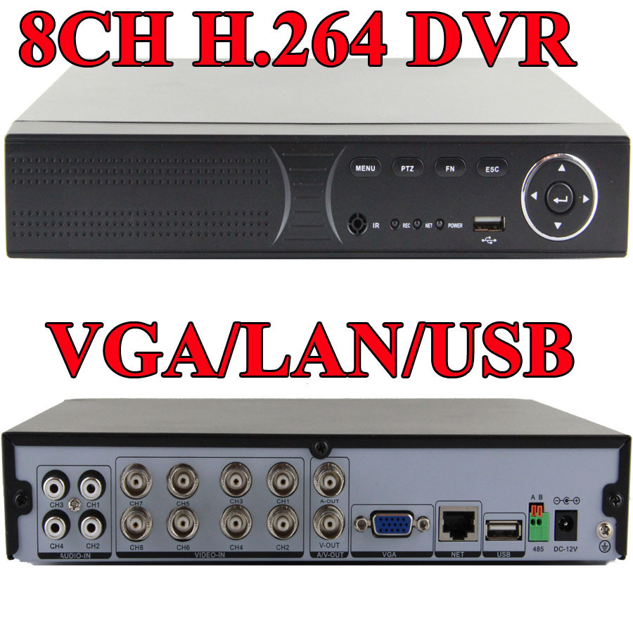

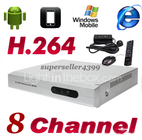

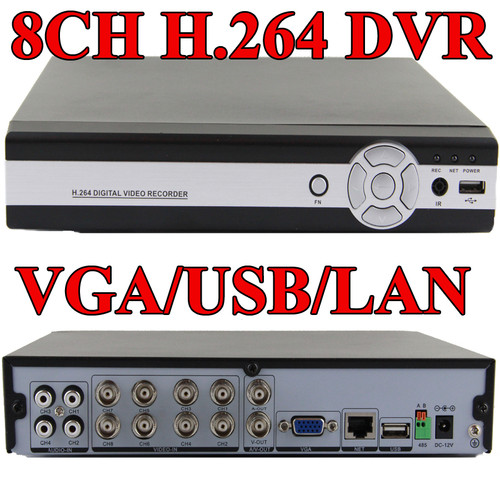

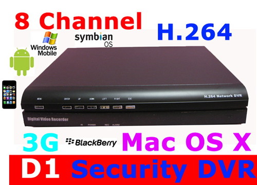

Mr. Anonymous 0 Posted September 4, 2012 Yeah I don't live in a ghetto or anything, 7-15fps will be fine but I do PC repair and large HDDs are easy to come by so I might be able to slap a big daddy in there and go 30fps all the time. Does live viewing support 30fps or do you have to view at the same specs your recording at?? I'm going to look through those cheap H264 DVRs on eBay and see if any are D1 Share this post Link to post Share on other sites
yakky 0 Posted September 4, 2012 Mr. Anonymous said: I'm going to look through those cheap H264 DVRs on eBay and see if any are D1 How much money do you think you are going to save on a cheap POS DVR versus getting a quality unit? You can buy a good 8 channel unit for $150. Share this post Link to post Share on other sites
Mr. Anonymous 0 Posted September 4, 2012 yakky said: Mr. Anonymous said: I'm going to look through those cheap H264 DVRs on eBay and see if any are D1 How much money do you think you are going to save on a cheap POS DVR versus getting a quality unit? You can buy a good 8 channel unit for $150. Link? Well seeing how I have $0 and am having a hard time finding work locally, a $60 D1 DVR might save $4,000 worth of AV equipment in my truck from being stolen. What's the difference between a $60 and $150 DVR besides it does not include a cheap Chinese HDD that I would rather install myself, a trusted model HDD. Then I can upgrade in the future to a better 4ch and use the cheap 4ch for just door cams where the target is so close extreme detail will not be necessary. Share this post Link to post Share on other sites
yakky 0 Posted September 4, 2012 Mr. Anonymous said: yakky said: Mr. Anonymous said: I'm going to look through those cheap H264 DVRs on eBay and see if any are D1 How much money do you think you are going to save on a cheap POS DVR versus getting a quality unit? You can buy a good 8 channel unit for $150. Link? Well seeing how I have $0 and am having a hard time finding work locally, a $60 D1 DVR might save $4,000 worth of AV equipment in my truck from being stolen. What's the difference between a $60 and $150 DVR besides it does not include a cheap Chinese HDD that I would rather install myself, a trusted model HDD. Then I can upgrade in the future to a better 4ch and use the cheap 4ch for just door cams where the target is so close extreme detail will not be necessary. If your goal is to save the $4000 worth of equipment, a DVR system isn't your best bet. Lots of other ways to protect your truck. What is the difference in a $60 and $150 unit? Real D1 recording vs upsampled. advanced scheduling features, better motion detection, better interface, after sale support, a real warranty. I had a cheaper DVR, a NightOwl, and Newegg was nice enough to take it back. The replacement Dahua based unit is night and day with the NightOwl. I'd send you a link but the forum moderator doesn't allow links to Selly's Nurplus. But if you are a person that compares specs and can't comprehend there being more to it than just raw specs (which are from the seller anyway), then yeah, get the cheapest D1 DVR you can find. Share this post Link to post Share on other sites
Mr. Anonymous 0 Posted September 4, 2012 I have my other method, a spotlight and a gun. Surveillance is just an added sense of security, I can deff say I do not need any motion detection or scheduling. Interface I could care less about as long as it functions, I'm a huge customer at Newegg they have taken monitors back over 2 years after I purchased them so I may try their DVRs. Raw specs are what makes something what it is, are you a brand name shopper? Unsampled D1 footage? They say real D1, do you mean recorded at a lower bitrate sort of thing? For someone who is new to the CCTV it might be best off to start small and really learn/see the difference for myself. Right now I have live view cameras which are doing me no good...what about a "cheap" single channel DVR? Get all the quality you rant about but dropping the channels I don't need/have cams for to compensate the price? If I can record just my Hitachi for now it will make me sleep better until I can afford to drop decent money on a multichannel DVR. Share this post Link to post Share on other sites
yakky 0 Posted September 5, 2012 Mr. Anonymous said: Raw specs are what makes something what it is, are you a brand name shopper? Unsampled D1 footage? They say real D1, do you mean recorded at a lower bitrate sort of thing? For someone who is new to the CCTV it might be best off to start small and really learn/see the difference for myself. Right now I have live view cameras which are doing me no good...what about a "cheap" single channel DVR? Get all the quality you rant about but dropping the channels I don't need/have cams for to compensate the price? If I can record just my Hitachi for now it will make me sleep better until I can afford to drop decent money on a multichannel DVR. Raw specs are often fudged. I'm not a brand shopper but I do trust certain brands to deliver a good user experience. Perfect example is how many of the DVRs claim to record in D1, but they upsample the image to D1 size. It takes more space, but offers no more resolution than CIF. Quality I'm ranting about? Dude.... you have me laughing. Buy the cheapest thing you can find. Go for it. You are so smart, everyone is trying to rip you off with their higher priced items. See you at Walmart! Share this post Link to post Share on other sites
Mr. Anonymous 0 Posted September 5, 2012 Hmm never thought about re-sampling, I've heard of that with camcorders and key-chain video cams. Good point Nah not always, I have some of the best brands and product lines in my truck advaible to the audio industry so it depends on what we are talking about. I will take your advice and buy a $150-$200 unit, any sites you recommend buying from? Where what I see I know are good products and I don't have to fish them out? Share this post Link to post Share on other sites
