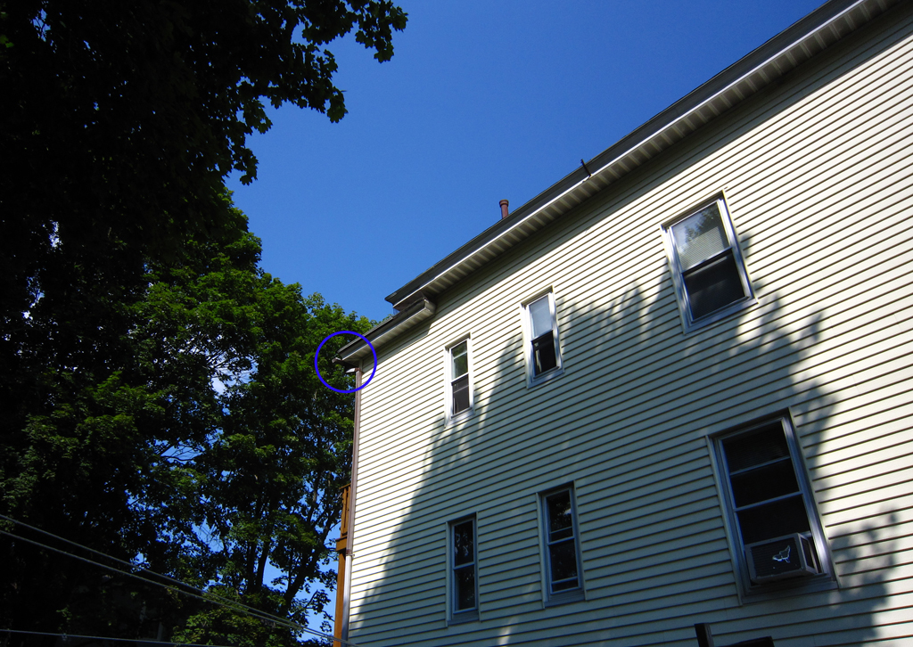

yakky 0 Posted September 1, 2012 Any junk camera is fine for monitoring daytime activity. Its when you get into nighttime activity or trying to ID faces is when you get into trouble. If you are after small covert style cameras, CNB makes some based on the 20s camera/DSP. They do ok at night with some light but really aren't suitable for anything more than seeing what's going on. Unfortunately they don't make any small cameras based on their 24VF. taUla1cVBOA The above video is my VFL-20S. Share this post Link to post Share on other sites
Mr. Anonymous 0 Posted September 2, 2012 So in theory it should have the same 600TVL 1/3CCD quality as yours? That's not too bad, from what the 3rd story or? I'm going to use motion flood lights for nighttime footage, even infrared flood lights would work with these cams right? I checked out your daytime footage it's not too bad for close things like doorways you can see detail in the bricks, but again for faces no way (3rd story?) This is where I want to watch for activity, also face identification on the top door only. The blue circle is where I can kill two birds with 1 stone with a camera: The gutter drain tube provides a tad bit of stealth, but I want to mount two cameras here; one facing the stairs/top door and another out the back facing my truck (blue circle): I would need to put a wide angle lens on it to get from the back of my truck to the foundation I think, I already have a camera in the basement window for face shots/identification were the blue circle is: I was thinking I could fit two of those $40 cameras into a universal bubble/dome for about the same price as a VFL-20S since the $40 barebone cams are not waterproof: Share this post Link to post Share on other sites
yakky 0 Posted September 2, 2012 Yeah, that camera is mounted at the top of the 3rd story. For day shots, the image quality will be the same. In tricky lighting situations it won't. The DSP on a camera makes a huge difference in what you see. I'd encourage you to buy a pricier camera from somewhere with a liberal return policy and test it out. I too tried to go the cheap route, but quickly realized that at night is when most of the bad stuff happens, and at night, cheap cameras stink! Share this post Link to post Share on other sites

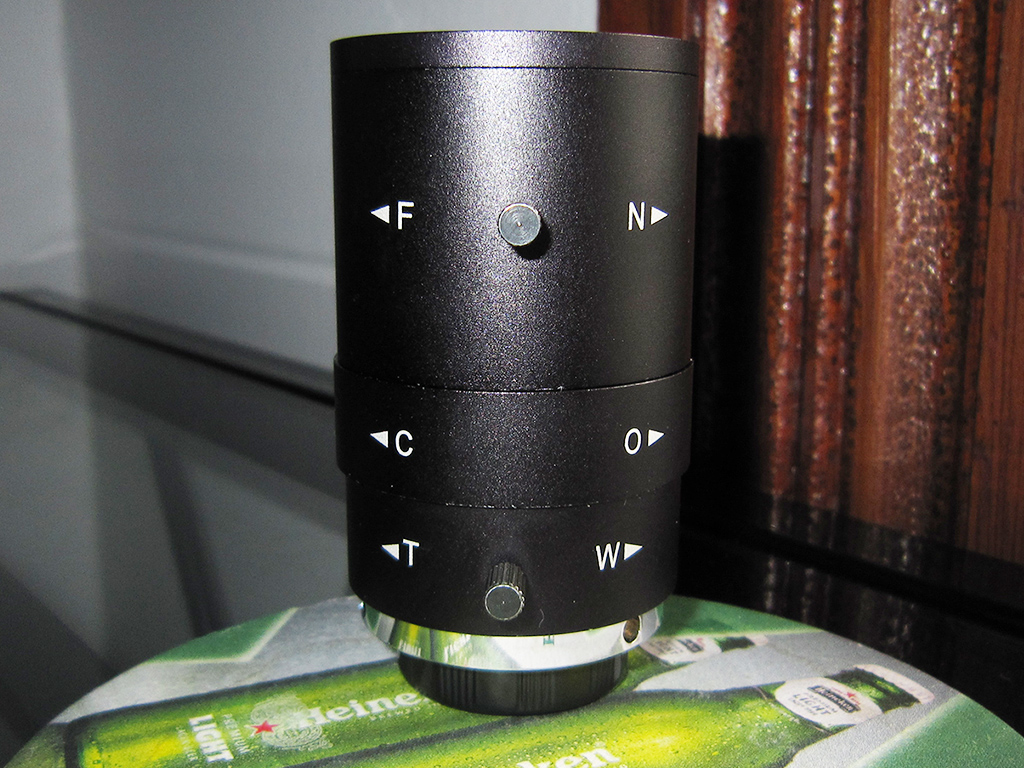

Mr. Anonymous 0 Posted January 12, 2014 Even the white balance/sharpness looks better on the mini ir dome. I do not think these WDAC's have an IR CCD or else I would just use an IR flood light. As far as lenses the manual says they accept C & CS type lenses, the one I have is a CS. Maybe I can just get a cheap fisheye for a few of them I think the adapter rings are for 16mm and 8mm lenses? (manual does not say) I assume the F & N stand for far and near focus? The C & O for open and closed iris? T & W though?? This lens seems best suited indoors in a set lighting environment like stores because of that manual iris....my Hitachi VK-C77U has an auto iris but I do not think it is working it stays over exposed all day. You can buy these for about $40-$50 that power up to 8 cameras so I was thinking about just buying a 120VAC-to-24VAC 50/60hz transformer and wiring it up myself because the transformer costs $10-$15 But for $20 I can but one of these...which would you use?? This block can run more then one camera anyway @50w right? Share this post Link to post Share on other sites
Mr. Anonymous 0 Posted January 14, 2014 When shopping for lenses I just go by "CS" ? Are there multiple thread sizes within a CS style lens? I see a "1/3" on my lens does that mean I need a CS lens with a 1/3" thread?? Share this post Link to post Share on other sites

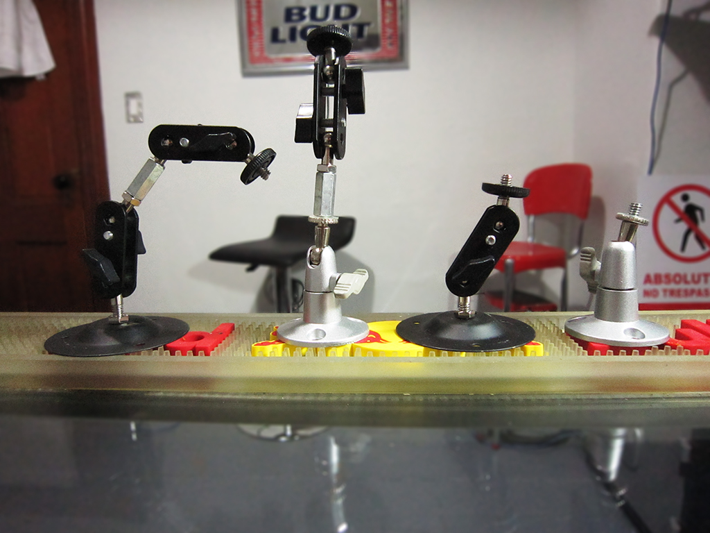

Mr. Anonymous 0 Posted April 19, 2014 I bought some cheap mounts for inside use, mainly top level floor window box cams. The two on the right are what they look like, I bought two silver mounts and a lot of four black mounts but I used the pieces from two of the black mounts to modify them along with couplers from the hardware store. I am not sure what combo I will use but the silver ones are for my narrow window sills...either way with the lens against the window I need to extend the mount. Share this post Link to post Share on other sites
