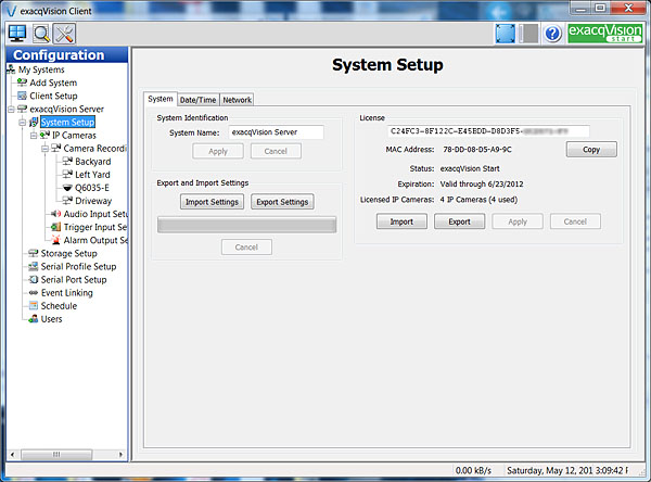

But now I think I need to apply that "4-camera" key they sent me.... and I don't have a clue.
Googled a little, tried the app's Help facility, but no joy.
Tried copying the key file to the parent program dir and each of the subdirs... but still no...
Anybody know how to apply that key?
You could visit my review of Exacq that walks you through the steps I went through, just sayin! This is the screen where you activate the license key.
Yeah, I finally stumbled into Configuration | Systems | [MySystemName] | System | System.

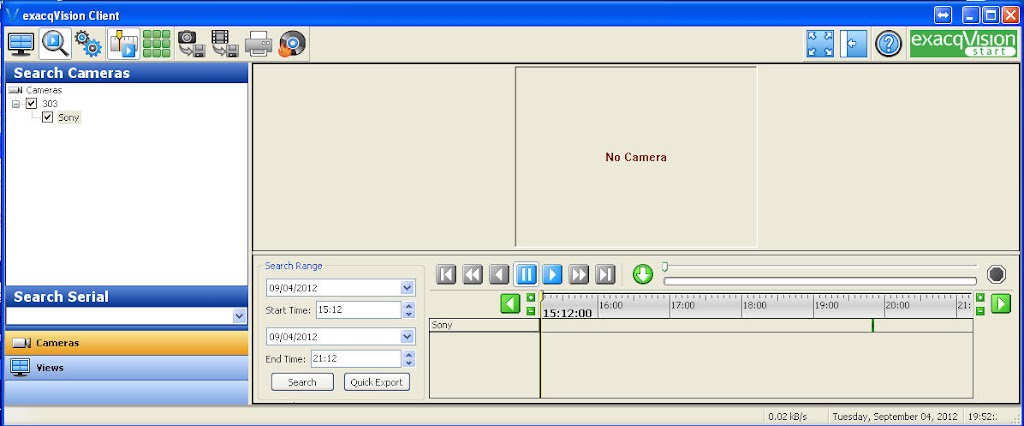

Went to Configuration | Systems | [MySystemName] | System | Schedule and tried changing the current hours on the cam's schedule from "Motion" to "Free Run" which I assume is Exacq's techspeak for continuous recording.
Still don't seem tb getting any recording.
My money is on recordings being there, but Yours Truly not making the right magic to see them: 200744_1.jpg
