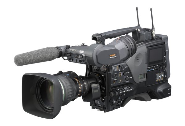

hardwired 0 Posted September 11, 2012 Also, because full 1080P Pro grade broadcast cams like this Sony PDWF800 run in the $30,000 range...$1200 doesn't even cover a lens. Share this post Link to post Share on other sites
MaxIcon 0 Posted September 12, 2012 Among the reasons this type of camera is both better and more expensive is that it uses 3 2/3" CCDs - one for each color - and they're designed for low noise and stable imaging. Throw in an expensive lens with great quality and light transmission, and you've got excellent low light performance. Now, to handle all this high def data, you need fast data paths, which makes for expensive electronics. The software, especially the compresson algorithms, is also much more finely tuned than on mainstream cameras. Throw in the build quality you'd expect from a $30k camera, and it all adds up, but it's the light path and sensors that are the heart of it. Share this post Link to post Share on other sites

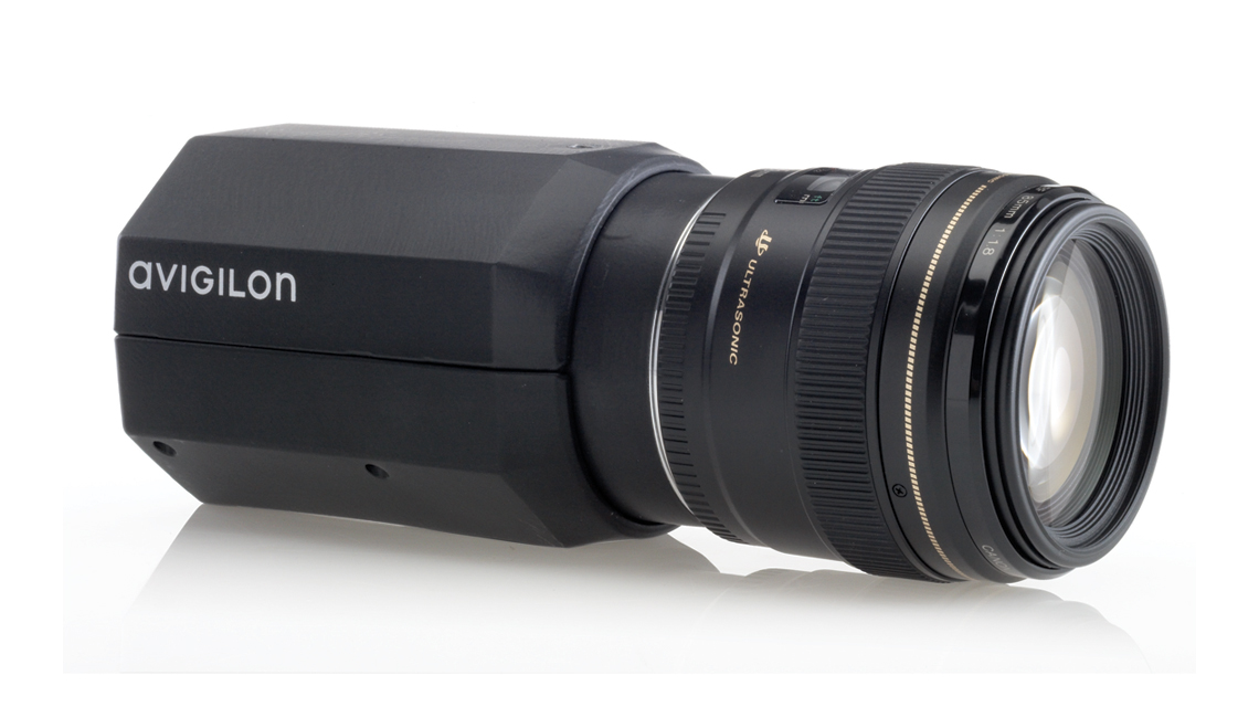

ssmith10pn 0 Posted September 13, 2012 http://avigilon.com/#/products/cameras/hd-pro-cameras/jpeg2000-hd-pro-camera/8-mp-jpeg2000-hd-pro-camera/tech-specs/ Share this post Link to post Share on other sites
PeteCress 0 Posted September 13, 2012 ssmith10pn said: http://avigilon.com/#/products/cameras/hd-pro-cameras/jpeg2000-hd-pro-camera/8-mp-jpeg2000-hd-pro-camera/tech-specs/ Just found a ccTV thread on it: viewtopic.php?f=19&t=11322&start=630 Share this post Link to post Share on other sites
