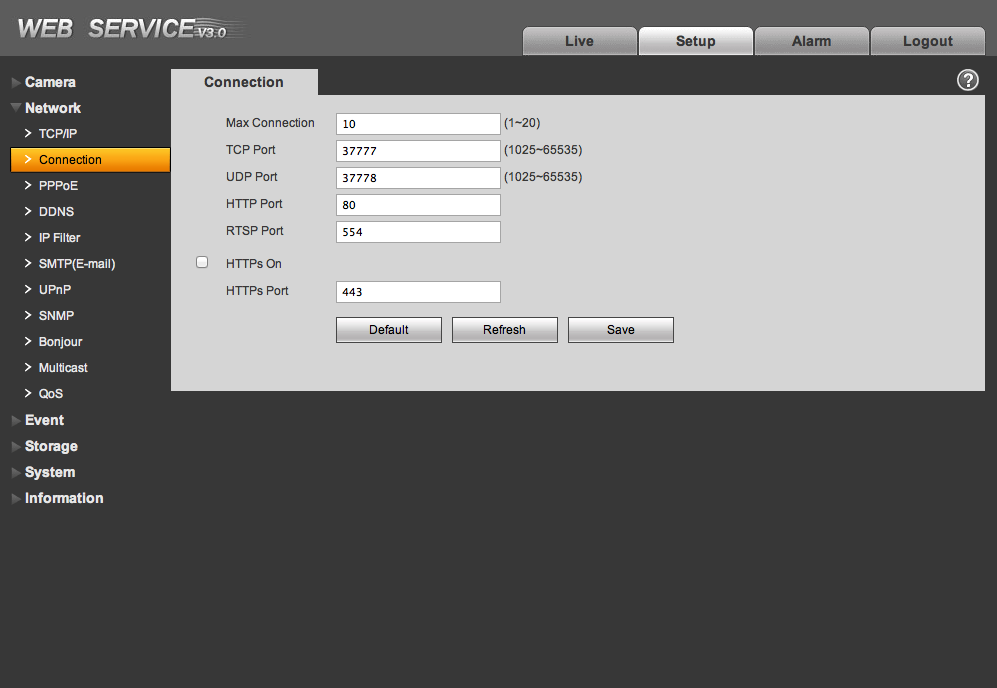

Here is what the camera settings are:

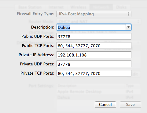

and here is the port forwarding in my Airport Extreme (I forwarded a bunch of ports in hoping I could get it to work):

The CAMERA's (not the DVR) IP is the default 192.168.1.108. Port 80 is forwarding correctly as I can access the web admin interface via my.ip.address:80 but the problem is that the video stream inside the web admin is not working - it has the "broken camera" icon. I was assuming that it's because the video stream needs a different port forwarded?
