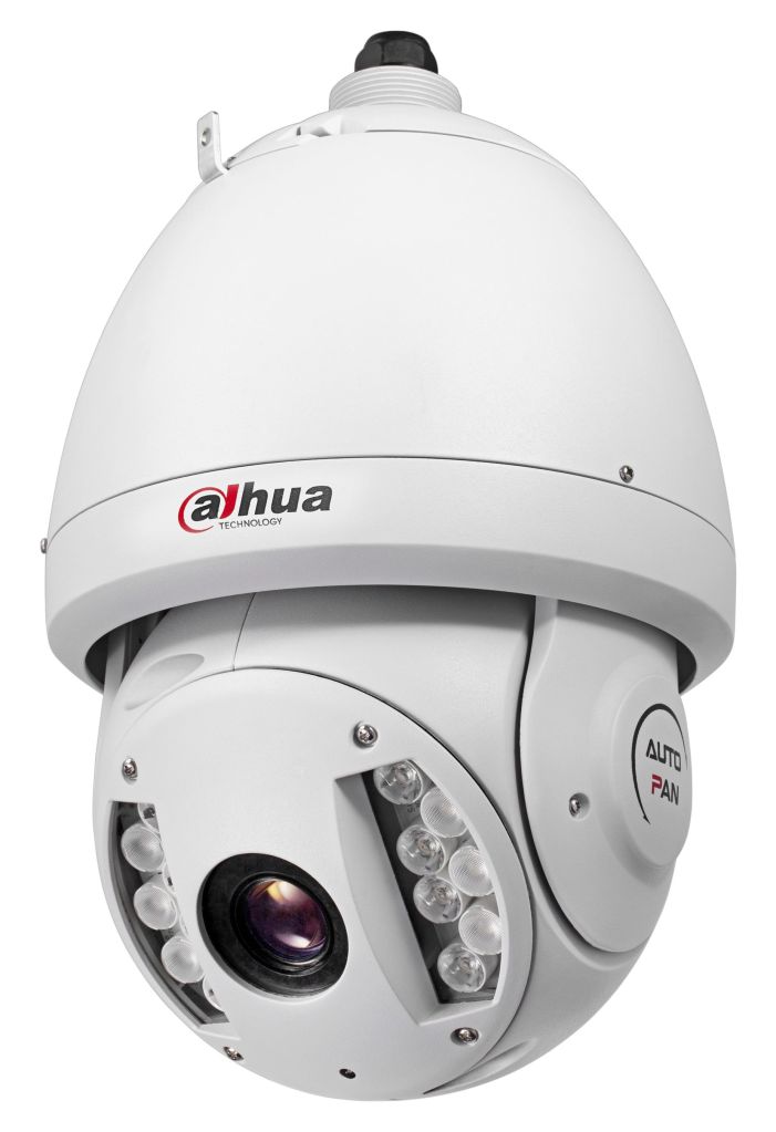

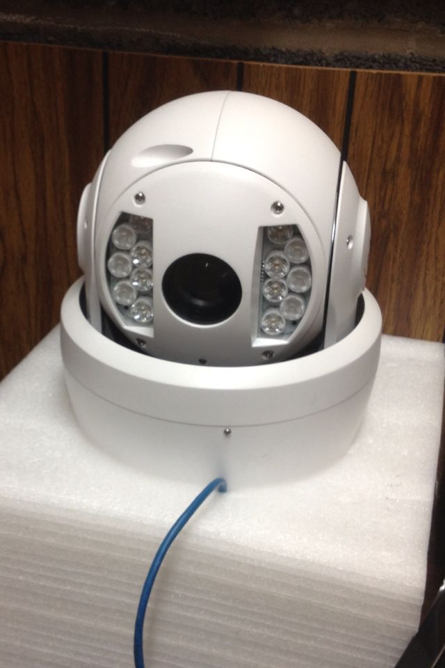

You should get one of these in that case. I have one for sale if your interesteed. It's a 1080P PTZ IP camera with analog out or ethernet out. It has two different IR's.
When you zoom in, the long range IR's kick in, and when you zoom out, the wide array kicks in. The clarity and colors are amazing. You can set up a guard tour or just
pan. It it definitely tells the bad guys that you mean business. It's big and mean looking.
