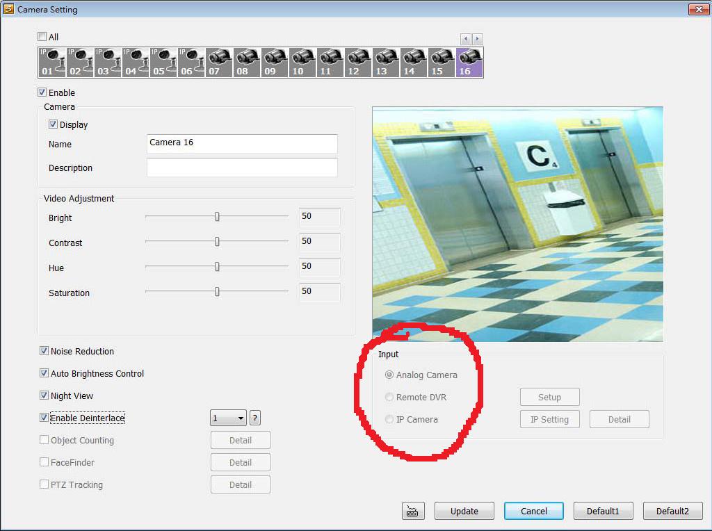

hi. nv will either work or not. you have a simple fix problem.
1. go into system
2. go into camera settings
then you will see analog or IP settings. make shure all cameras are set to analog
