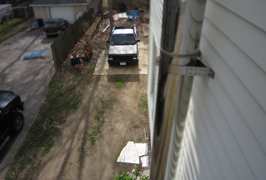

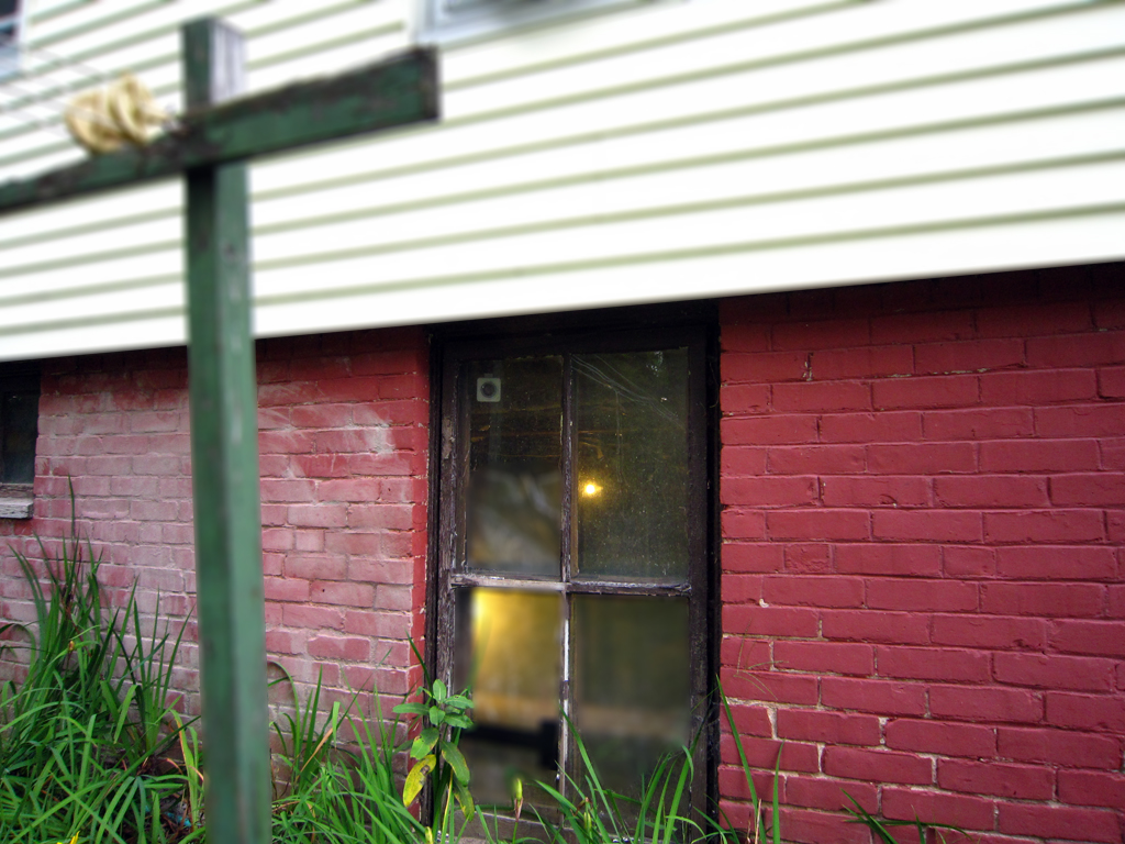

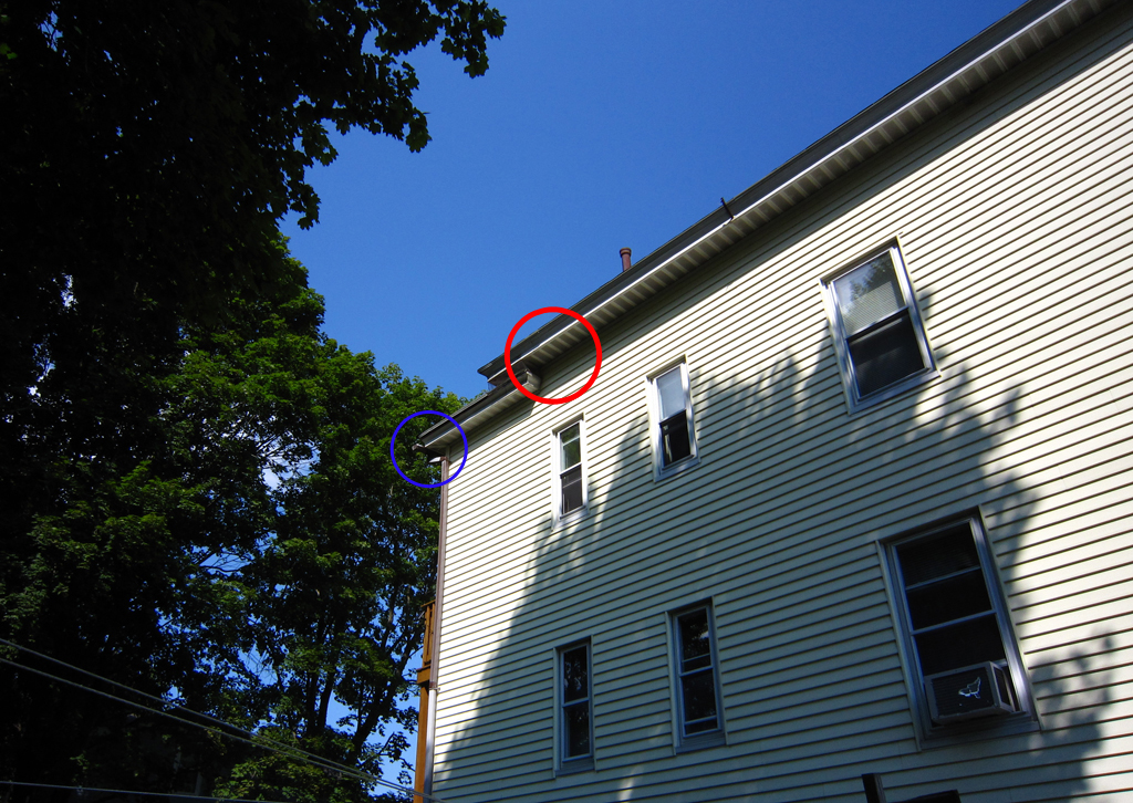

Mr. Anonymous 0 Posted September 23, 2012 Let me start by stating the intentions of my design, basically I'm just a techy person so it's a gadget/novelty but I do have some true need. I live in a good neighborhood however I think my neighbor is up to no good he comes and goes at all hours of the night so I hear a car door outside my window and have to look every time to make sure it's not someone jumping out of a car to mess with my truck which contains a lot of valuable electronics. Besides for that minor threat doorway surveillance/etc is just a convenience so I'm going to start on a small budget with this, here are some photos to help you get a better idea of my property. This view is out of a middle window on the second floor: I set up a full D1 Hitachi VK-C77U in the basement window if you look in the blue circle, this is zoomed in and framed up wit the windshield and doors for a clear face shot and identification: I would like a birds eye view of the area surrounding my truck so I'm thinking about mounting a camera in the blue circle, it would hide well behind the gutter: The same birds eye view location could mount a second camera (see blue circle) to monitor the doorway activity on both floors, face identification on second floor...both of these being cheap D1 cameras: Motion lights will be in use, possibly not on the stairway but at such a close range the camera IR might be strong enough for the second floor door which is approximately 5ft away. I won't put the motion lights for my truck next to the birds eye view camera for range purposes but on the opposite corner of the house which is closer to my truck. Anyone have some advise and/or opinions? Share this post Link to post Share on other sites
liveaboard74 0 Posted September 24, 2012 Camera's would be better off under the top eve where no one could get to them but mount them near/over the big window where you can get to them easy if spiders are bad in your area. You'll learn quickly if they are or not with night vision. LOL Leaning out of a window with a broom is a lot easier than carrying a ladder over to the side of the house once a week. Have twin systems and twin drive way alarm set up. One upstairs and one down stairs. Chamberlain drive way reporters are a nice cheap addition. 1100 foot drive and have 4 reporters for the down stairs. Nice thing about them is every reporter has its own number of beeps. If you set 4 reporters up, one will make your inside unit beep 4 times. Next one 3, next one 2 and then one. You know where someone is on the property by how many beeps there are. Upstairs same way. Anyone comes in the gated drive, we know it then half way down the drive, then at the back of the house. They last about 4/5 years. 150 for 4 on amazon or e bay. Just sticking up my second set. Upstairs and down. Share this post Link to post Share on other sites

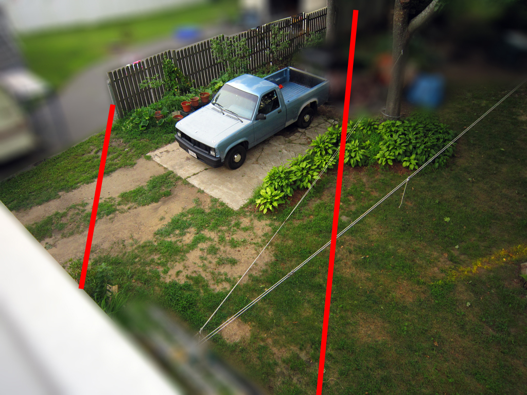

Mr. Anonymous 0 Posted September 25, 2012 Well the blue circle IS under the eave and accessible from the top of the stairs (both blue circles are the same spot) but I see what you mean...so more like mount it where the red circle is? I was looking into the driveway alarms, I think one for each red line will work sufficiently beaming off the house. Other zones of the house and doorways will be a future thought: Share this post Link to post Share on other sites
mike_va 0 Posted September 25, 2012 High cameras are fine for an overview but if someone wears a hat not uncommon you will not get a useful shot. Share this post Link to post Share on other sites
Mr. Anonymous 0 Posted September 26, 2012 mike_va said: High cameras are fine for an overview but if someone wears a hat not uncommon you will not get a useful shot. That's what this bad boy is for at ground level framed up with my truck but if someone knew in advance they could easily come in from the side and stand in front of it. The other high camera for the door will work well but the lower stair case is just a plus within the frame; not of concern. That leaves the high camera on my truck but that is just for a wider angle further around the truck than a ground level can capture. Share this post Link to post Share on other sites

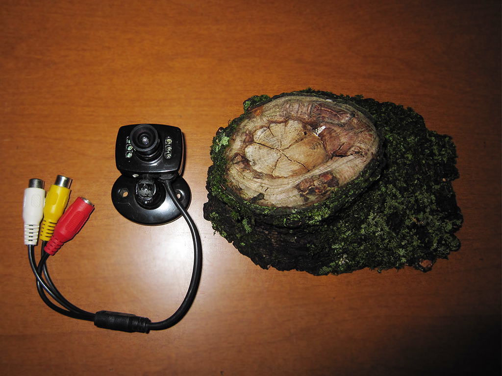

Mr. Anonymous 0 Posted August 1, 2013 I have a bunch of TTL high frequency 75 ohm cable laying around and this cheap small black and white camera so I'm going to mount it in a tree in front of my house on the sidewalk really stealth like: I am going to hollow out this scared branch crotch and drill a hole for the lens out the front where the dead wood is. That way it can be screwed onto the tree in front of my house, I removed all the useless IR LEDs that were consuming power and heating up the unit now it runs much cooler...I just need to waterproof the casing and I am good to go (the cam was free anyway eve if it lasts a year it's only black and white but sharp). The question now is can I run a 35ft wire between the AC/DC adapter and the camera to keep from having wall voltage in a tree?? Share this post Link to post Share on other sites

Kawboy12R 0 Posted August 4, 2013 Mr. Anonymous said: The question now is can I run a 35ft wire between the AC/DC adapter and the camera to keep from having wall voltage in a tree?? Yes. Share this post Link to post Share on other sites
