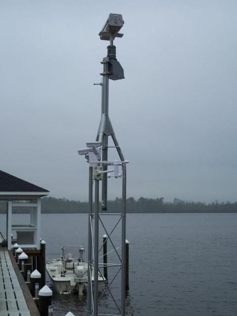

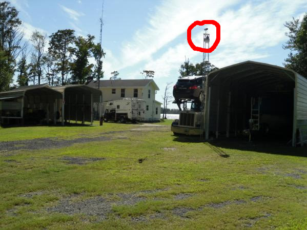

liveaboard74 0 Posted September 25, 2012 I hope it's easdy to access on the tower for maintenance purposes. I have seen lots of cameras mounted in such a way as to require a $300 1/2 day hire of a boom lift just to clean away a few cobwebs.Free standing tower I use to install them. One I took down and still easy to climb. Old kid here. Still stretch chains and climb rails hauling cars on a 10 car stinger rig so getting up and down that tower is the easy part. Might pay for it day after tomorrow but you know the deal..Seems like a good idea today. Already learned my lesson on the others and spiders.. Wet summer its almost a every week thing cleaning camera's off. If only they would put windshield wipers on the PTZs... The only camera I'm not real happy with I circled . Its the only one thats wireless. Nice picture during the day but night it has a white blur to it.. Thats for another thread. VHF antenna on top of tower and taking the tv antenna down under it.. Build a mount for the side of the tower and install. I have learned one thing about keeping spiders away for a short time. Don't think it really matters what brand but I soak the camera down and all around it with bug and spider killer from lowes . Keeps them off it for at least 4 to 5 weeks then it wears off but have one on a tv rotor on the pier and if I didn't spray that one its a every night thing. GF gets to do that duty.. LOL Good woman. Dang good woman. LAMO. Share this post Link to post Share on other sites

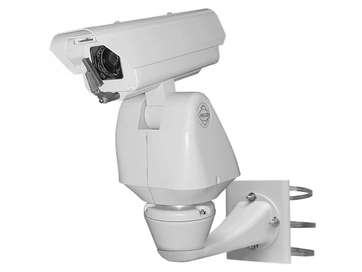

GrouchoBoucho 0 Posted September 25, 2012 pelco esprit is the way to go. not cheap, but will work forever. Share this post Link to post Share on other sites
liveaboard74 0 Posted September 25, 2012 pelco esprit is the way to go. not cheap, but will work forever. O lord it does have a windshield wiper. LOL Hey,, I ask ... Bounced over rear quick and use e bay and a tool for finding things. 3000 grand down to 450 used.... Thank you.. 1. Have 2 questions one on the wireless and already see you guys know these things. Are there any wireless camera's that will give you a clean picture at night . 2. How long a run can you make with a 12v system and still pull down a clear picture? Thanks again. Share this post Link to post Share on other sites
