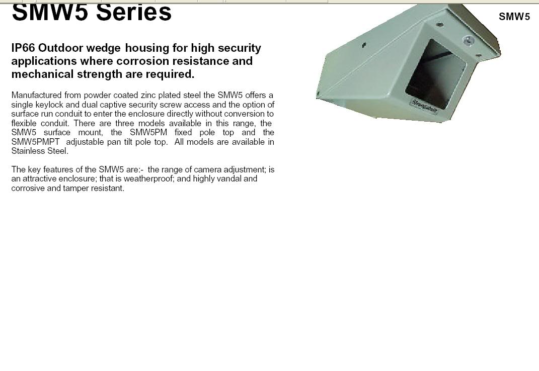

cctv_down_under 0 Posted October 19, 2005 For this kind of application we usually use a surface mounted wedge housing, bit ugly though but very strong..hardly aesthetic Share this post Link to post Share on other sites
