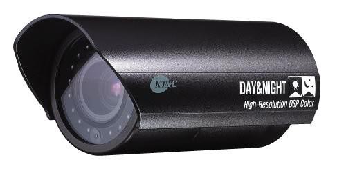

34Ford 0 Posted October 19, 2005 Wow, Im glad you guys post the pics. After seeing this I think I will look at the N600H1 again. And here looks like a good price. http://www.digitalsurveillancesolutions.com/security_cameras-KT&C--KPC-N600H1.htm Share this post Link to post Share on other sites

34Ford 0 Posted November 29, 2005 Well after installing 2 more N600H1's I found out something about the halo issue. The N600H1's come in a black housing and these wizkids are white. So trying to make my 600's blend in to my white vinyl trim on the house I used some white vinyl used to make signs and I covered the camera with this. Looks great. However....when I used the white on the underside of the sun shield, then the halo appeared. This could be the problem with these wizkids. Share this post Link to post Share on other sites

34Ford 0 Posted November 29, 2005 Well that may be true about the dirty lens. But I just know for a fact that the white sunshield made a halo and when I removed it, no halo. Which I thought maybe if they had black under the sunshield of the wizkid maybe it would help. From what I saw of the pic, that is the way mine looked till I removed the white vinyl. Share this post Link to post Share on other sites
