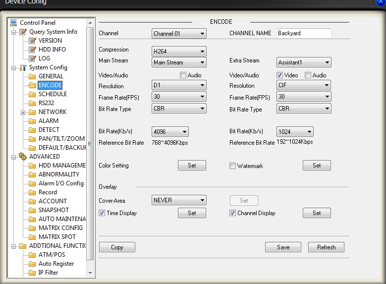

Not sure if it's the same model as yours, but this is a Dahua 16 channel DVR that I have in the field up and running. The main stream and extra stream bit rate is going to be different. A cell phone and a PC cannot handle the same bit rate. Here is a screen shot of channel 1's settings.
I watched that video from sck and saw them discuss the bitrate thing for local and streamed. It looks like you're using the software to connect to the DVR and make adjustments. Have you turned all cameras on constant record at D1 at the same time? If you did, did you see a CBR from all cameras? Also, I see in the software there's reference up to 5k for the main channel, can this be bumped up higher or is 5k max for all cameras?
