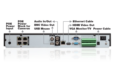

Firefighter 0 Posted November 7, 2012 Okay so their sending 8 Chan NVRs out? Are they 8 POE?????? Or just 4 POE but support 8 cams. Share this post Link to post Share on other sites
gabe 0 Posted November 7, 2012 Okay so their sending 8 Chan NVRs out? Are they 8 POE?????? Or just 4 POE but support 8 cams. we need pics, at poe ports Share this post Link to post Share on other sites
bike_rider 0 Posted November 7, 2012 Okay so their sending 8 Chan NVRs out? Are they 8 POE?????? Or just 4 POE but support 8 cams. I think it is pretty clear in that letter that there are 4 POE ports. Share this post Link to post Share on other sites
lowpro 0 Posted November 7, 2012 From the Q-See website..... 8-Port Looks like they (4,8,16 port) all have the same backside. Share this post Link to post Share on other sites
lowpro 0 Posted November 7, 2012 Got the approval from the CFO (wifey) ; placed my order. Hopefully I'll receive an 8 channel one. Here is a new review that was left for the package on the costco website.. "I believe this is the technology of the future. If you want 16 cameras, be advised you will need four systems, and each will require a connection to a network switch (or hub) or a router with several ports. The alternative will be to network the IP cameras to a network hub or switch that will be connected to a (multi-port router). I'm returning my two 4-port systems tomorrow." hmmmmmm Share this post Link to post Share on other sites
gabe 0 Posted November 7, 2012 i can't see just offering 4 poe on a 8ch - 16ch nvr. most obvious software would be limited to 8 & 16ch. "chime in" ron or jharrell low i think thats a stock picture. Share this post Link to post Share on other sites
buellwinkle 0 Posted November 7, 2012 It's true, all versions of the NVR, be it 4,8 or 16 that have PoE ports, have only 4 PoE ports. Here's more detail from Dahua - http://www.dahuasecurity.com/products/nvr320432083216-p-190.html Share this post Link to post Share on other sites
gabe 0 Posted November 7, 2012 It's true, all versions of the NVR, be it 4,8 or 16 that have PoE ports, have only 4 PoE ports. Here's more detail from Dahua - http://www.dahuasecurity.com/products/nvr320432083216-p-190.html well if your quoting it buellwinkle then i believe it. awesome deal for $700 (plus tax) if you get the 8ch. Share this post Link to post Share on other sites
RonD 0 Posted November 7, 2012 Correct only 4 POE ports Share this post Link to post Share on other sites
buellwinkle 0 Posted November 7, 2012 In their brochure, they show a 16 channel NVR diagram with 4 PoE ports on the back. You can get 4 port PoE switch for a reasonable price in the $60 range. I had Trendnet but have since switch to ZyXel because a) they run on 110V (no transformer like the Trendnet) and b) they provide 15.4W per port for all ports (Trendnet is 30W max for all 4 ports). Share this post Link to post Share on other sites
