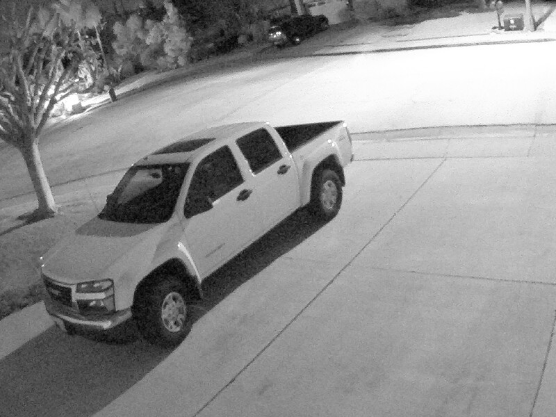

buellwinkle 0 Posted November 2, 2012 It switched over to night mode, finally and it's looks like daytime with just the street light, no other light. Also, you can change the write interval in the advanced setup under recording group, it's set to 300 which confirms that it creates 5 minute long files. Share this post Link to post Share on other sites
