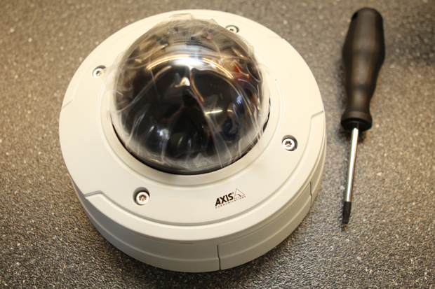

Hello everyone! Wrote up a review, with plenty of day/night photo and video samples of course, of the Axis P3364 1MP dome camera.

I didn't have the same difficult experience that you did with the silver tabs (I think they work quite nicely!), but I do not have the 3364-VE, I have the 3346-VE and 3367-VE, but the casing and everything is the same, just a different sensor.

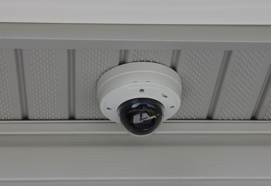

I just got one of these 3364-VE cameras and installed it last night. I just want to append to the comments of the previous review, this is a VERY good camera. The quality, and the lens quality in particular at 2.5mm wide angle is good... I really appreciate the noticeably wider FOV when using this camera in a corner residential location as it lets me keep tabs on a larger area of my property.
Night performance is head and shoulders above that of my Vivotek, and with my Axton IR illuminator it is quite impressive.
The camera offers backlight compensation and also offers WDR. I'm still playing around with the settings to get the best image setting but already a big improvement over the Vivotek, which I will be selling soon.
