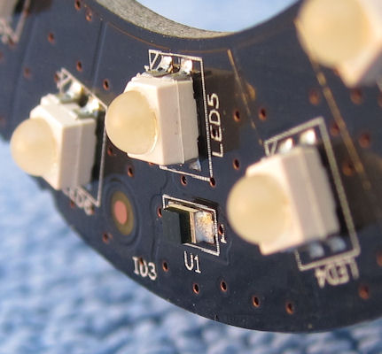

MaxIcon 0 Posted January 24, 2013 Yes, sounds like the IR is reflecting back into the sensor, causing an oscillation. The Dahua doesn't use the lens signal to turn the IR on and off, just the sensor on the IR board, so loss of lens isolation shouldn't cause flickering IR. The sensor for the IR responds very quickly, while the through-lens response for light levels is quite slow. It sounds like either the sensitivity of the sensor has changed, causing it to turn on and off with the IR, or there may be an IR filter that goes over the sensor that has fallen off. This would make sense, if the sensor sees IR at all, as you only want it to respond to white light, not IR, to prevent this type of problem. CdS sensors aren't very sensitive to IR, while Si sensors are, so it'll depend on what kind they use. I haven't looked closely at mine to see if there's a filter or not. Sounds like another weekend project. Share this post Link to post Share on other sites

MaxIcon 0 Posted January 25, 2013 I took a look at my HFW3300C and HFW2100, and the sensor is a tiny chip on the bottom of the IR board. It's hard to tell if it's got an IR filter over it, as I didn't have time to take anything apart, but it would need one if it were IR sensitve, since you'd get quite a lot of reflection from the back of the glass. If you can compare the boards easily, you might be able to tell if there's a difference between the sensors. Share this post Link to post Share on other sites
finalwish 0 Posted January 25, 2013 Agreed. Can't tell if it has IR filter on it or not, and no difference between the working vs non-working sensors. Saw this thread viewtopic.php?f=19&t=33075 and the sensor is similar to the pictures in the thread. Share this post Link to post Share on other sites
MaxIcon 0 Posted January 28, 2013 I took my HFW3300C apart this weekend, and got some pics of the sensor up close. It's still hard to tell, but the black rectangle on top could be an IR filter over the actual sensor. It should be pretty obvious if this is different from yours. It appears the IR is directly controlled by the electronics, not by the CPU and software, as it will turn on and off as soon as the camera's powered up, long before it's booted. My front glass also had some haze on the inside surface, which took a little effort to clean off. If there's residue on the glass that's IR reflective, it could cause flickering. The good news is that it will work fine with the IR board disconnected, which is different from cameras that use the IR board sensor to control the day/night transition (like the Vivotek 1MPs). It's the only way I know of to disable it, for those who want to use external IR. Share this post Link to post Share on other sites
finalwish 0 Posted January 28, 2013 It looks like mine is the same. MaxIcon said: I took my HFW3300C apart this weekend, and got some pics of the sensor up close. It's still hard to tell, but the black rectangle on top could be an IR filter over the actual sensor. It should be pretty obvious if this is different from yours. It appears the IR is directly controlled by the electronics, not by the CPU and software, as it will turn on and off as soon as the camera's powered up, long before it's booted. My front glass also had some haze on the inside surface, which took a little effort to clean off. If there's residue on the glass that's IR reflective, it could cause flickering. The good news is that it will work fine with the IR board disconnected, which is different from cameras that use the IR board sensor to control the day/night transition (like the Vivotek 1MPs). It's the only way I know of to disable it, for those who want to use external IR. Share this post Link to post Share on other sites
