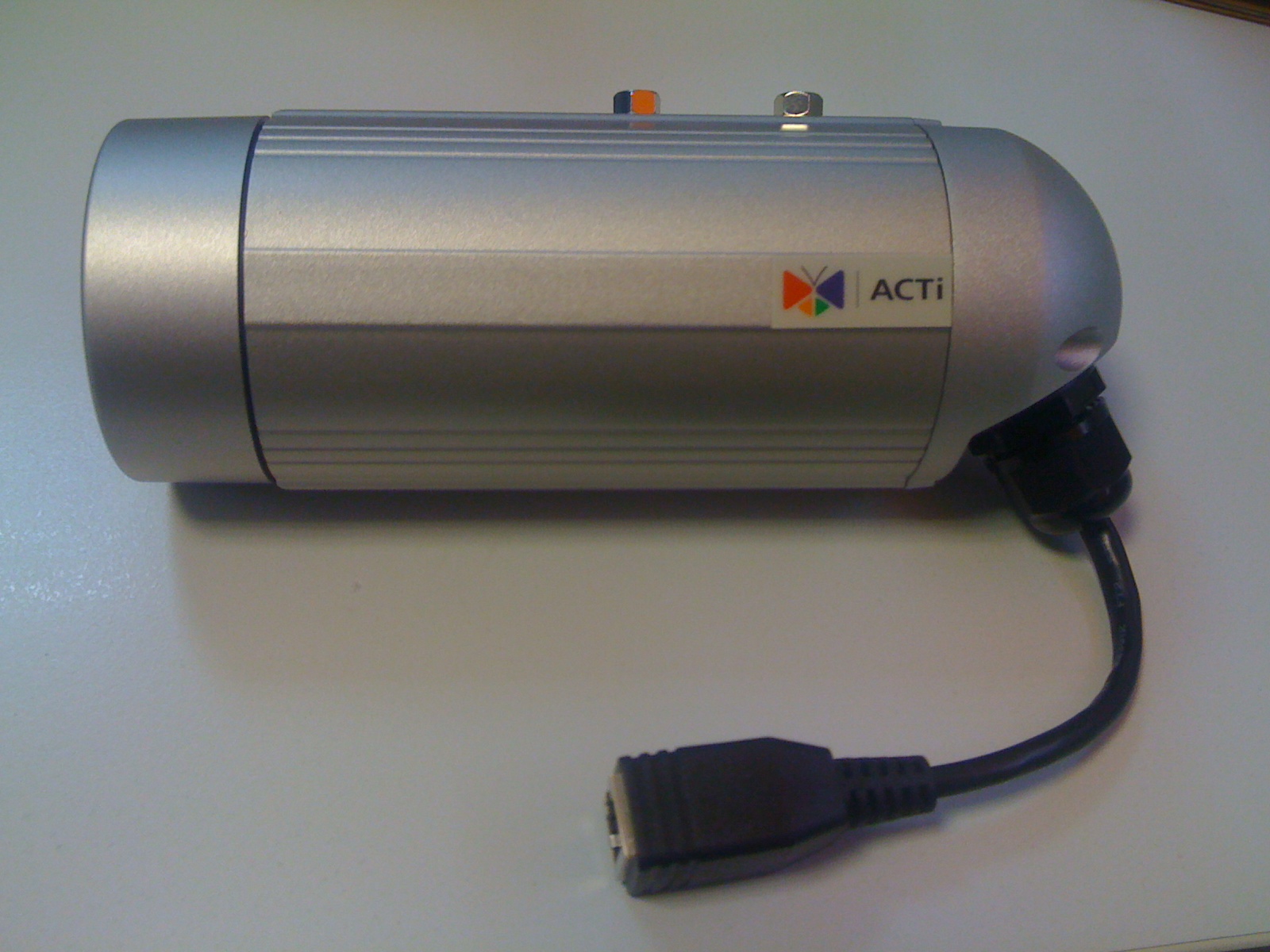

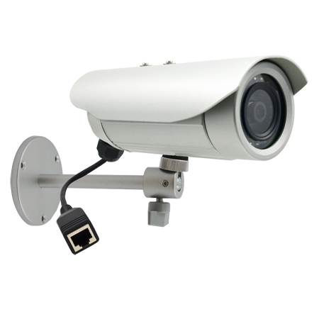

thewireguys 3 Posted November 29, 2012 If this is the real image of the new e** cameras this is the dumbest design I have ever seen for a camera let along an outdoor camera. Share this post Link to post Share on other sites
Razer_SE 0 Posted November 29, 2012 The camera tail is just a removable tail so you can run the wire directly into the back of the camera as normal if you want. Not sure why the heck they did that, but I might use the tail as all my cameras are box mounted anyway so I can use it either way I suppose. Agree it's odd though, and I despise those cheap mounts but coming with any mount is better than no mount at all I guess? Share this post Link to post Share on other sites

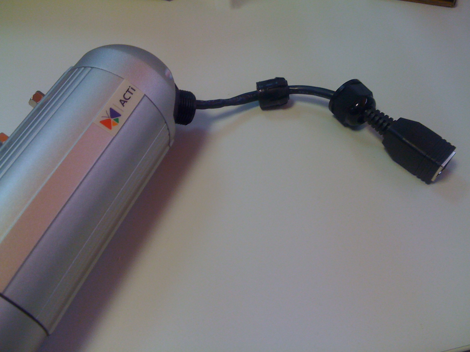

thewireguys 3 Posted November 29, 2012 The camera tail is just a removable tail so you can run the wire directly into the back of the camera as normal if you want. Not sure why the heck they did that, but I might use the tail as all my cameras are box mounted anyway so I can use it either way I suppose. Agree it's odd though, and I despise those cheap mounts but coming with any mount is better than no mount at all I guess? I think you have to cut the cable IF they have a RJ45 at the other end. If it is the same design as the old 1231 you could not pass a cat5 cable with a RJ-45 end on it though the Cable Gland. Share this post Link to post Share on other sites
buellwinkle 0 Posted November 29, 2012 The fixed that since the TCM-1231 and yes, very annoying trying to crimp an rj45 on a ladder. Share this post Link to post Share on other sites
thewireguys 3 Posted November 29, 2012 The fixed that since the TCM-1231 and yes, very annoying trying to crimp an rj45 on a ladder. On the new E** cameras where are the connections for audio and I/Os?. The only reason I can think that they did what they did so you could bench test the camera without having to dissemble them. No problems crimping rj45s I have done thousands of them. Share this post Link to post Share on other sites
ando 0 Posted November 30, 2012 In the past we used to have indoor bullets (like ACM-1511) and outdoor bullets (like TCM-1231). The new E3x series is so cost efficient that can be positioned as both indoors and outdoors (or semi-outdoors). For indoor and semi-outdoor solutions, you can go with the external pigtail (1) for your convenience. The installations under open sky could be done with one of the two: (2). using flex conduit (there is a conduit fitting in the package that has a size big enough to let RJ-45 pass through. It is identical to TCM-1231 solution. (3). use the existing connector, without flex conduit. Just remove the pigtail and insert your own cable and do the crimping on the spot. The camera comes with the light metal bracket - good enough for ceiling and wall for most cases. The optional heavy duty brackets for E3x are also available (TCM-1231 optional bracket). E series bullets are divided into fixed lens (E3x) and vari-focal lens (E4x) models. Share this post Link to post Share on other sites

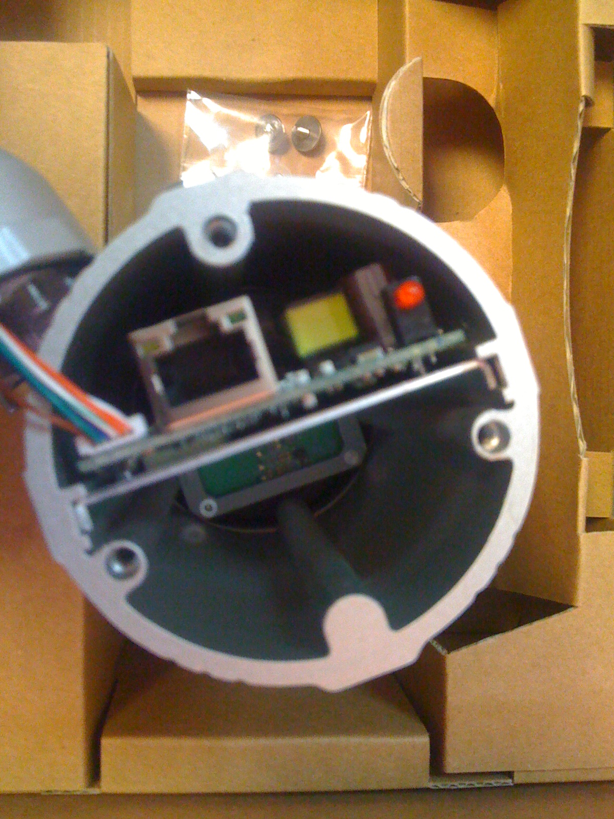

Korgoth Of Barbaria 0 Posted November 30, 2012 Here are some pictures: With tail: Inside: As you can see there are 2 ethernet ports, for normal RJ45 and terminal/flat one. As for image, I have some movie samples made in my "hood", just uploading them on youtube, will update with link. Inside, 0.05 lux or less, fast shutter: OjSUes6ofIU outside, fast shutter, moving objects QHOUPOjb-MU outside WDR test: tJWC_-chXHU Share this post Link to post Share on other sites
