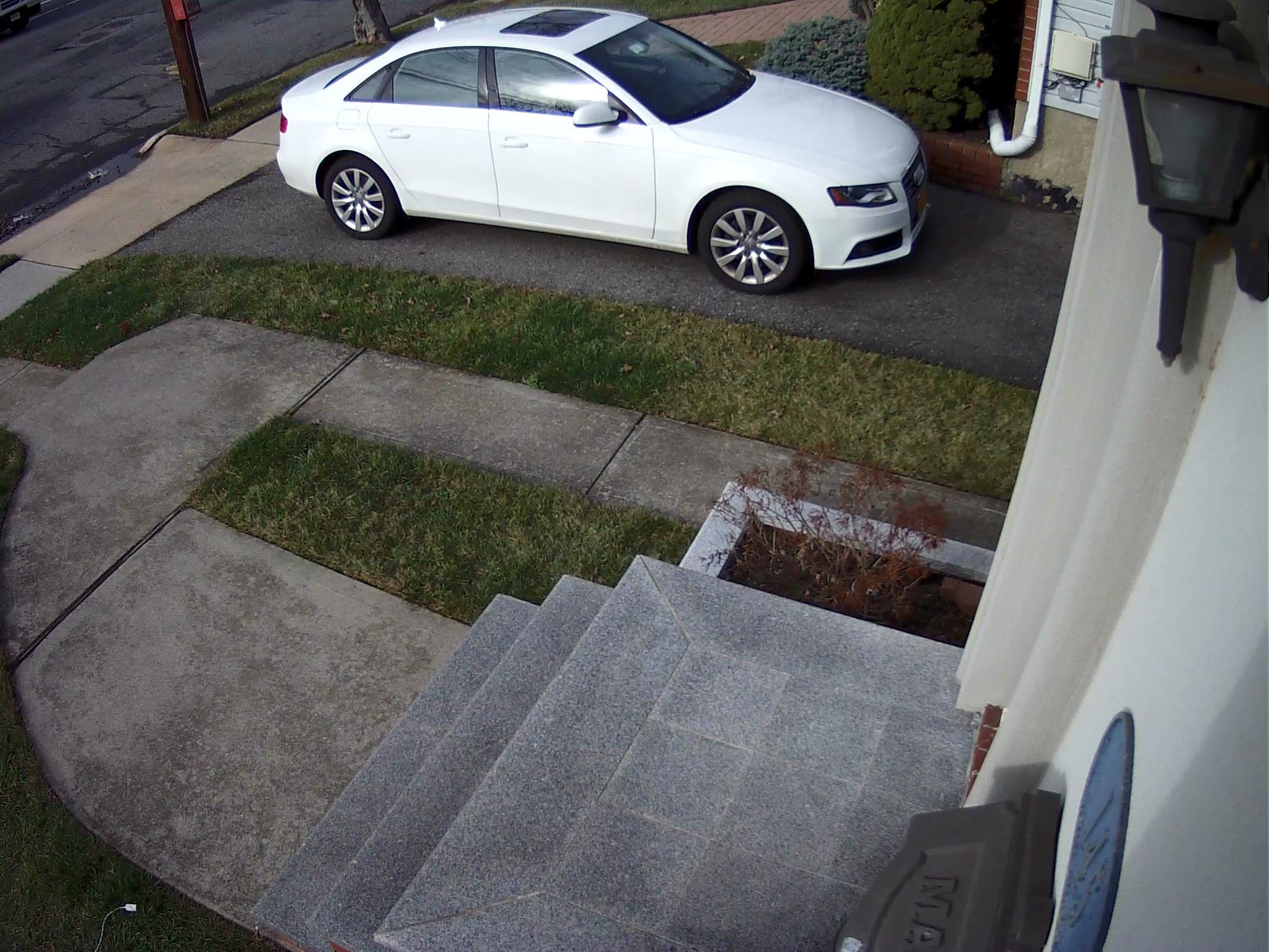

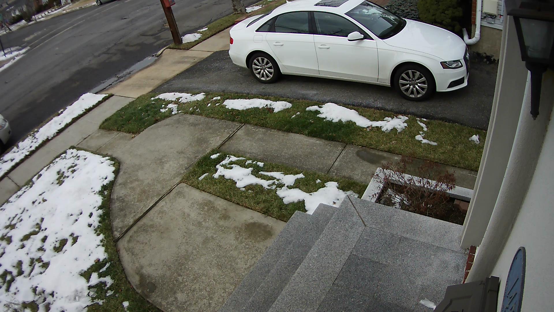

ilkevinli 0 Posted January 31, 2014 MaxIcon let me know what you think about it. I had one to test and I noticed that even though it was a 3.6mm lens, I got less coverage than my other 3.6mm lens cameras. See images. So it looks like the 4XXX series uses different firmware than the 3XXX series: 2XXX/3XXX series = HX3(2)XXX 4XXX/5XXX series = HX5(4)XXX This makes sense, as the 4300 uses a different sensor and (presumably) CPU than the 3300/3200/2100. I've ordered a 4300S to test, against my better judgement, and will see what firmware it comes with and whether I'll have any better access to firmware updates (probably wishful thinking). Anybody know about English NTSC firmware for the 4300S? Googling the key bits of the firmware name above only gives that novosec site - one result. Share this post Link to post Share on other sites

MaxIcon 0 Posted February 1, 2014 MaxIcon let me know what you think about it. I had one to test and I noticed that even though it was a 3.6mm lens, I got less coverage than my other 3.6mm lens cameras. See images. Definitely different, though that may be due to the different sensor or a different vendor for the 3.6mm lens. Is the bottom image the 4300S? It doesn't look that good compared to the top image, and part of it appears to be the lens quality... I'll measure the FOV when mine arrives - hopefully any day now. Share this post Link to post Share on other sites

ilkevinli 0 Posted February 2, 2014 Yep. The bottom is the 4300 and the top was the 3200. I wasn't that impressed either, that's why I'm curious to see what you think. MaxIcon let me know what you think about it. I had one to test and I noticed that even though it was a 3.6mm lens, I got less coverage than my other 3.6mm lens cameras. See images. Definitely different, though that may be due to the different sensor or a different vendor for the 3.6mm lens. Is the bottom image the 4300S? It doesn't look that good compared to the top image, and part of it appears to be the lens quality... I'll measure the FOV when mine arrives - hopefully any day now. Share this post Link to post Share on other sites
buellwinkle 0 Posted February 2, 2014 It's not that one is better than the other, it's that they are different. The 3200S uses the Sony Exmor sensor, very nice looking picture from it but the issue I had with it is that it's too contrasty and over saturated which makes a prettier picture if that's your goal, but to me the new Aptina sensor in the 4300S has a naturally wider dynamic range but has a duller, less prettier picture but to me has more value for security. They sell both kinds, so the choice is yours to make, but I can see the value in the 4300S over the 3200S. You can tweak the settings on the 3200S to look more like the 4300S and vice-versa but it won't be 100% the same. For example, you can set WDR on the 3200S but it's done in software, so it won't be quite as good as the 4300S and may actually look duller to achieve the same results. You can set the contrast and saturation up on the 4300S, but will never look quite as good as the 3200S. Since I can't decide, I use Hikvision and ACTi, LOL! Share this post Link to post Share on other sites
ilkevinli 0 Posted February 2, 2014 buellwinkle why do you think the 4300 does not have the same field of view as the 3200 when they were both 3.6mm lens ? They are both made by Dahua, so I find it very odd. It's not that one is better than the other, it's that they are different. The 3200S uses the Sony Exmor sensor, very nice looking picture from it but the issue I had with it is that it's too contrasty and over saturated which makes a prettier picture if that's your goal, but to me the new Aptina sensor in the 4300S has a naturally wider dynamic range but has a duller, less prettier picture but to me has more value for security. They sell both kinds, so the choice is yours to make, but I can see the value in the 4300S over the 3200S. You can tweak the settings on the 3200S to look more like the 4300S and vice-versa but it won't be 100% the same. For example, you can set WDR on the 3200S but it's done in software, so it won't be quite as good as the 4300S and may actually look duller to achieve the same results. You can set the contrast and saturation up on the 4300S, but will never look quite as good as the 3200S. Since I can't decide, I use Hikvision and ACTi, LOL! Share this post Link to post Share on other sites
pelo666 0 Posted February 2, 2014 Images you have uploaded are of different aspect ratio. The upper (3200) is full HD 16:9 and the bottom (4300) is 4:3... What is the size of picture sensor? The lens could be the same, but if the sensors are different you achieve diefferent field of view. Check the tech specs of that cameras what field of view they should have... Share this post Link to post Share on other sites
