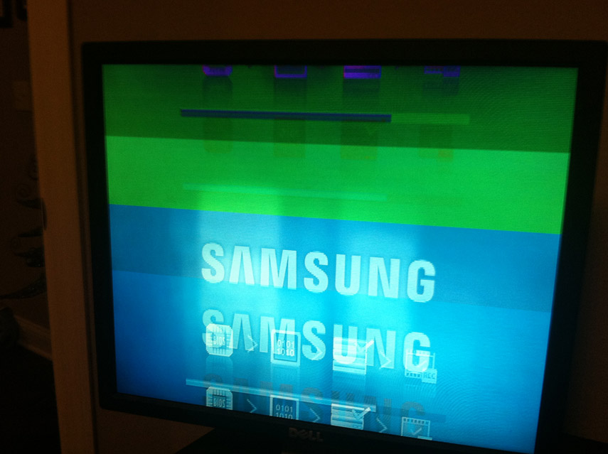

The "SDE-3170_3002_V1.02_101119.nbn" file was extracted from the ZIP and placed on a thumb drive. The thumb drive was pushed into the front of the DVR and through the DVRs menu and it located the firmware and performed the upgrade. First a progress bar appeared, which went all the way to the right and maxed out for several minutes before the upgrade was complete. A beep was heard, it rebooted.
I am using the VGA output of the DVR for monitoring. The boot screen is now jacked up (as you can see in the image), but once the DVR came up, there seems to be no other impacts from the alternate firmware update. However, the upgrade, brought the DVR to V1.02_101119 from V1.01_100720 on the system information screen.

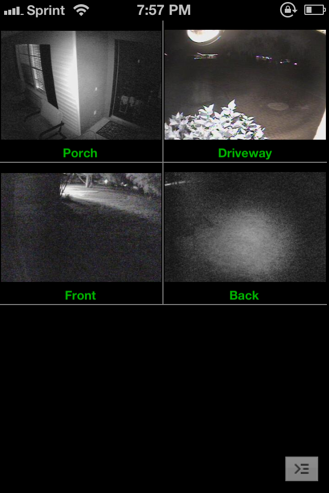

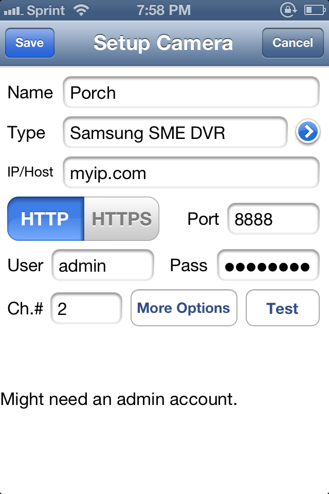

So, after communicating with the friend who has successfully used this DVR on his Android device, I gave him test credentials on my DVR. He set it up successfully and sent me his configuration. The trick: apparently the RTSP driver just altogether doesn't work for either device. All along, he has had his phone set up as HTTP, which essentially just downloads images at a rapid rate, as I understand it. In order to get the option to use HTTP, instead of RTSP, you must select "Samsung SME DVR" instead. Once that was selected, and the connection details entered, it worked. See images below (please note, in the third image, I recognize it says port 8888, but that was not the port I was using all along for RTSP testing; I just made the screenshot in a hurry):
Image 1: Working Cameras
Image 2: SME Settings including HTTP option
